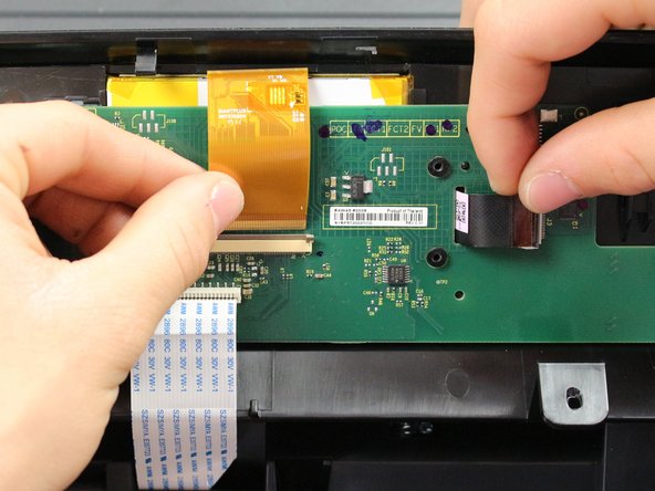

    3. HP Envy 7640 Screen Replacement: crwdns2935265:03crwdnd2935265:01crwdnd2935265:02crwdne2935265:0 HP Envy 7640 Screen Replacement: crwdns2935265:03crwdnd2935265:02crwdnd2935265:02crwdne2935265:0
      • Undo the two connectors by gently pulling them away from the board.
      • Remove the last connector by flipping the tab up and pulling away from the board while also pulling left.

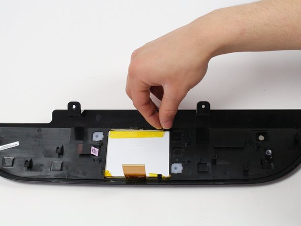

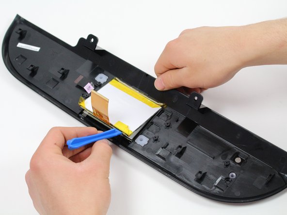

      • Peel back the tape that holds the screen in place.
      • Insert the plastic opening tool between the white screen backing and the screen to pry the screen backing from the adhesive that holds it in place.
