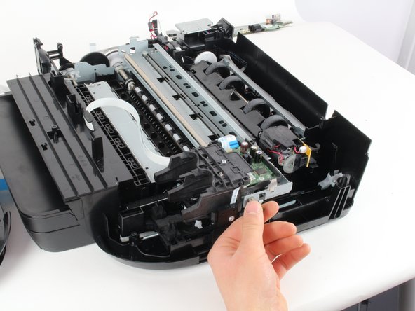

      • Open the printer by pushing upwards on the plastic tabs located on the sides of the printer.
      • Remove the opening assist from its purchase by pushing it toward the front of the printer with a nylon spudger.
      • Remove the spring-loaded clip attached to the top of the printer by pushing it off of the hook.

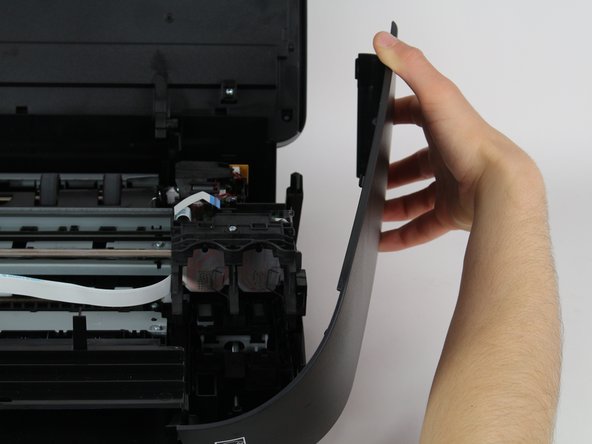

      • Remove the last ten 12mm screws by placing the Torx 9 screwdriver in the screw slot and turning counterclockwise.
      • Remove the last two 12mm screws by placing the Torx 9 screwdriver in the screw slot and turning counterclockwise; the screen plate can now be separated from the printer by pushing out and to the right.
      • Take out the inner plastic frame (this piece is removeable after having removed the ten 12 mm screws outlined in the first bullet) by grasping the frame with both hands and carefully pulling the frame away from the printer body.

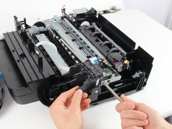

      • Grasp the gray lever of the black plastic cover of the rollers and gently pull the lever up and to the right.

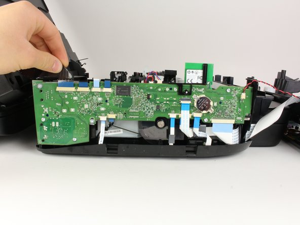

      • Detach all the cables by gently pulling on them at their base in the direction of origin (for top connectors pull up and for bottom connectors pull down).

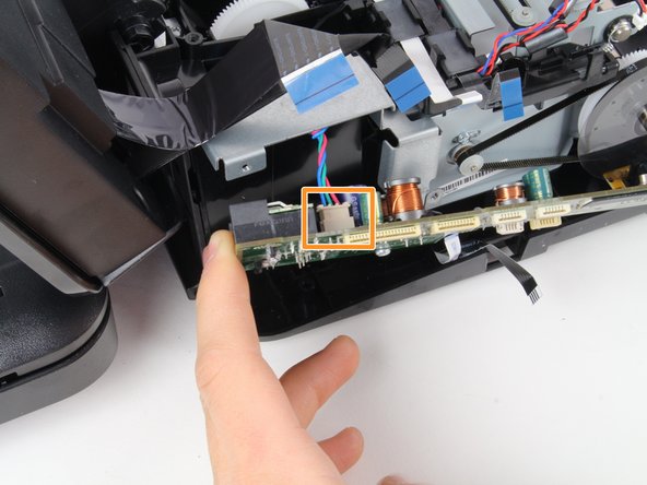

      • Remove the last two connectors found at the top of the motherboard by grasping the tan portion adjacent to the motherboard and pulling up.

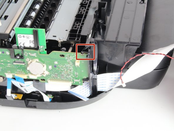

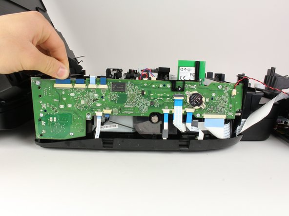

      • Start to remove the motherboard from the device by lifting the left hand side of the motherboard out from the printer shell with minimal force.
      • Push the clip's head away from the motherboard to release the right hand side of the motherboard from the printer shell.
      • Remove the back connector by firmly grasping the tan portion of the connector adjacent to the motherboard and pulling in toward the printer to dislodge the motherboard.

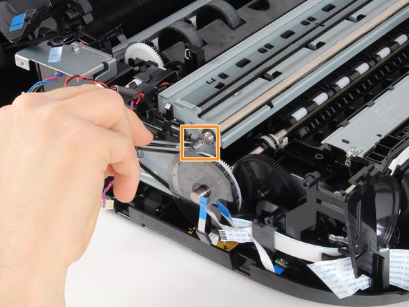

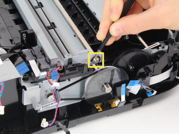

      • Place the T9 Torx screwdriver in the screw slot and turn counterclockwise to extract the single 14 mm screw.
      • Using the blunt tweezers, detach the spring by grasping the end attached to the fuser assembly and pulling out and away.
      • Using the blunt tweezers, remove the black, ribbed washer by prying away from the print rail.

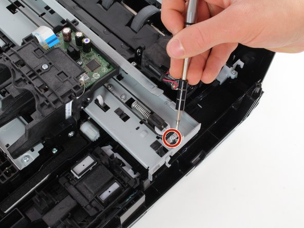

      • Place the T9 Torx screwdriver in the screw slot and turn counterclockwise to remove the single 12 mm screw.

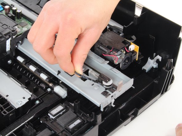

      • Grasp the black, elastic band firmly and pull out and away from the white plastic pulley; the printhead can now be lifted out of the printer.
