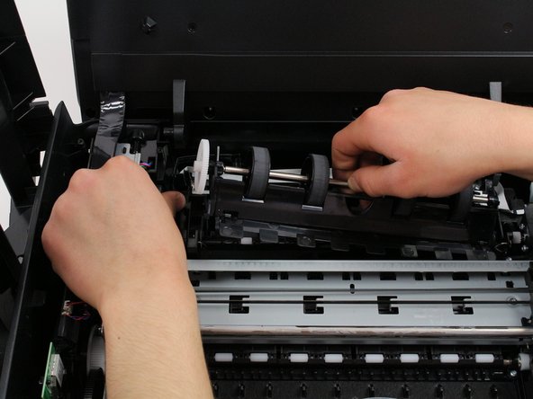

    4. HP Envy 7640 Encoder Strip Replacement: crwdns2935265:04crwdnd2935265:01crwdnd2935265:03crwdne2935265:0 HP Envy 7640 Encoder Strip Replacement: crwdns2935265:04crwdnd2935265:02crwdnd2935265:03crwdne2935265:0 HP Envy 7640 Encoder Strip Replacement: crwdns2935265:04crwdnd2935265:03crwdnd2935265:03crwdne2935265:0
      • Press the lever outwards and away from the paper rollers with one hand.
      • Pull the paper rollers up and out of your HP printer with one hand while the other continues to depress the lever away from the paper rollers.

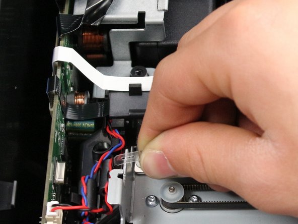

    1. HP Envy 7640 Encoder Strip Replacement, Encoder Strip: crwdns2935265:05crwdnd2935265:01crwdnd2935265:02crwdne2935265:0 HP Envy 7640 Encoder Strip Replacement, Encoder Strip: crwdns2935265:05crwdnd2935265:02crwdnd2935265:02crwdne2935265:0
      • Pull the encoder strip toward the slot it rests on to relieve the tension on the hook and slide the strip off the hook.

Thank you so much for this thorough explanation. You clearly understand how to repair HP printers. Perhaps I’m using an incorrect term for the very thin white plastic strip on the right hand side of the cartridge carrier. This strip is a fraction of the size of the strip on the left hand side of the carriage. This is the thin strip that is disconnected and which I would like to reconnect.
