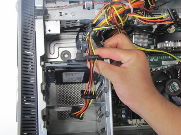

    • Locate the SSD inside the open case.
    • Unplug the SATA power cable from the hard drive by pulling straight up.
  5. HP Envy 700-030qe Solid State Drive Replacement: crwdns2935265:05crwdnd2935265:01crwdnd2935265:01crwdne2935265:0
    • Finish disconnecting the hard drive by unplugging the black SATA interface cable by pulling up.
