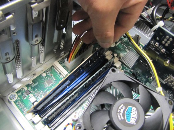

  3. HP Envy 700-030qe RAM Replacement: crwdns2935265:03crwdnd2935265:01crwdnd2935265:02crwdne2935265:0 HP Envy 700-030qe RAM Replacement: crwdns2935265:03crwdnd2935265:02crwdnd2935265:02crwdne2935265:0
    • Undo the clips on each end of the chip as shown in the second picture.
    • Then you may carefully remove the RAM chips by pulling them out by their the ends.
    • Make sure you pull the chips out by the ends and not grabbing the entire thing. This may damage the chips.
    • Remember the slots that you take the RAM chips from. You must put the two replacement chips in the same slots.
