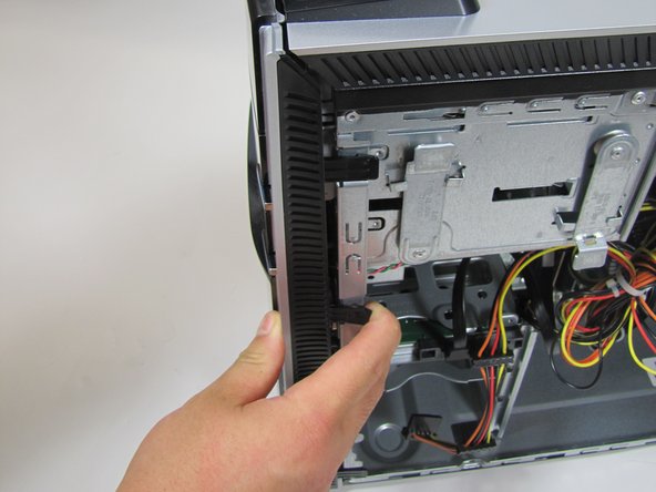

    • Now stand your desktop up and remove the 3 clips on the right side of the front panel.
    • Then pull the front panel off, pulling from the side that the clips are on.
