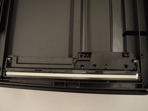

  8. HP Envy 5660 Scanner Piece Replacement: crwdns2935265:08crwdnd2935265:01crwdnd2935265:02crwdne2935265:0 HP Envy 5660 Scanner Piece Replacement: crwdns2935265:08crwdnd2935265:02crwdnd2935265:02crwdne2935265:0
    • Pry the old scanning glass up with a metal spudger.
    • There are adhesives under the scanning glass. Be careful not to break the glass while removing it.

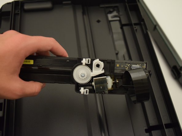

  9. HP Envy 5660 Scanner Piece Replacement, Scanner Piece: crwdns2935265:09crwdnd2935265:01crwdnd2935265:03crwdne2935265:0 HP Envy 5660 Scanner Piece Replacement, Scanner Piece: crwdns2935265:09crwdnd2935265:02crwdnd2935265:03crwdne2935265:0 HP Envy 5660 Scanner Piece Replacement, Scanner Piece: crwdns2935265:09crwdnd2935265:03crwdnd2935265:03crwdne2935265:0
    • The scanning piece is located in the bottom half of the scanner that was not separated from the printer.
    • Lift the scanning piece and detach the ribbon cable by gently pulling on it.
