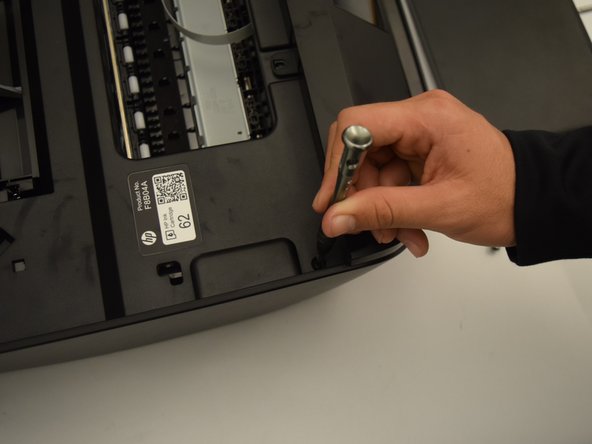

    • Open the cartridge access area.
  2. HP Envy 5660 Scanner Glass Replacement: crwdns2935265:02crwdnd2935265:01crwdnd2935265:01crwdne2935265:0
    • Remove the three 11.5 mm screws with a T10 bit.
  3. HP Envy 5660 Scanner Glass Replacement: crwdns2935265:03crwdnd2935265:01crwdnd2935265:03crwdne2935265:0 HP Envy 5660 Scanner Glass Replacement: crwdns2935265:03crwdnd2935265:02crwdnd2935265:03crwdne2935265:0 HP Envy 5660 Scanner Glass Replacement: crwdns2935265:03crwdnd2935265:03crwdnd2935265:03crwdne2935265:0

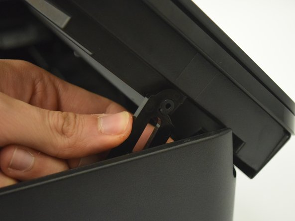

    • Locate the cover hinge on the right side of the printer.
    • Pull the hinge off of the scanner to allow the scanner to open to 90 degress.

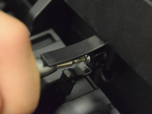

    • Remove the 11.5 mm screw with a T10 bit to release the spring-loaded hinge.
    • Since this is a compression spring, the hinge will snap downwards as soon as it is loosened.

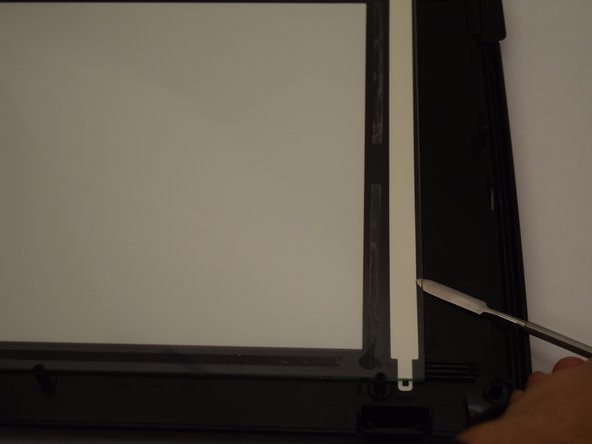

  8. HP Envy 5660 Scanner Glass Replacement: crwdns2935265:08crwdnd2935265:01crwdnd2935265:02crwdne2935265:0 HP Envy 5660 Scanner Glass Replacement: crwdns2935265:08crwdnd2935265:02crwdnd2935265:02crwdne2935265:0
    • Pry the old scanning glass up with a metal spudger.
    • There are adhesives under the scanning glass. Be careful not to break the glass while removing it.
