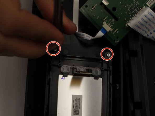

    • Remove the two 12 mm screws with a T10 bit.

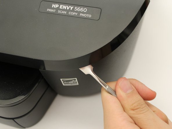

    • Use a metal spudger to pry open the front panel.
    • Work your way all the way around the front panel doing the same.

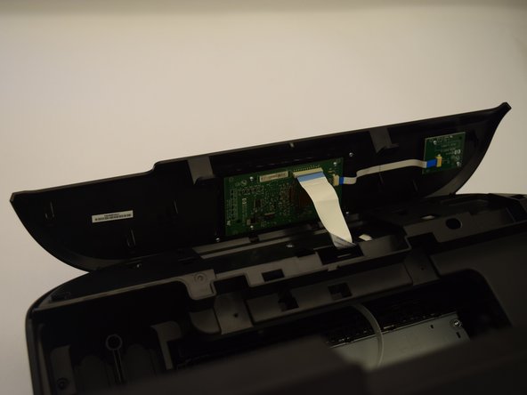

    • Gently flip the cover over, exposing the motherboard.
    • There will be loud popping sounds when the cover is being separated from the rest of the printer.
  4. HP Envy 5660 LCD Replacement: crwdns2935265:04crwdnd2935265:01crwdnd2935265:02crwdne2935265:0 HP Envy 5660 LCD Replacement: crwdns2935265:04crwdnd2935265:02crwdnd2935265:02crwdne2935265:0
    • Remove the four 4.5 mm screws from the motherboard with a T6 bit.
    • Gently remove the motherboard from the top of the LCD, but make sure the ribbon cables are still attached.
    • Beware damaging the white ribbon cable.
  5. HP Envy 5660 LCD Replacement: crwdns2935265:05crwdnd2935265:01crwdnd2935265:02crwdne2935265:0 HP Envy 5660 LCD Replacement: crwdns2935265:05crwdnd2935265:02crwdnd2935265:02crwdne2935265:0
    • Remove the four 5 mm screws with a T6 bit, allowing you to separate the LCD from the cover,
  6. HP Envy 5660 LCD Replacement: crwdns2935265:06crwdnd2935265:01crwdnd2935265:01crwdne2935265:0
    • Place the metal spudger underneath the LCD and gently lift up to remove the LCD.
