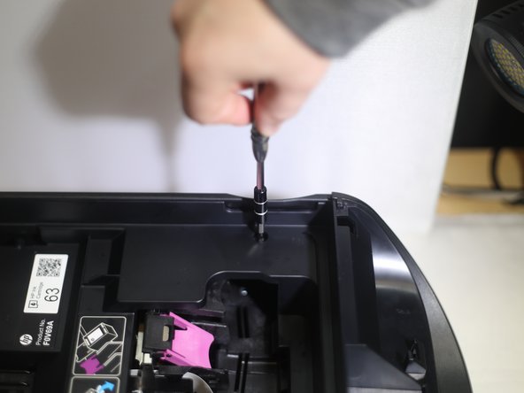

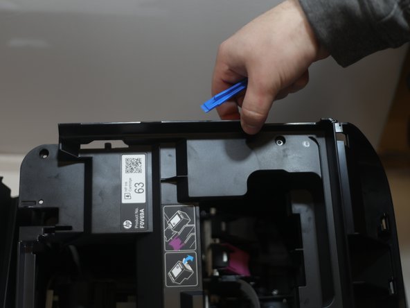

  3. HP Envy 4520 AC Adapter Replacement: crwdns2935265:03crwdnd2935265:01crwdnd2935265:03crwdne2935265:0 HP Envy 4520 AC Adapter Replacement: crwdns2935265:03crwdnd2935265:02crwdnd2935265:03crwdne2935265:0 HP Envy 4520 AC Adapter Replacement: crwdns2935265:03crwdnd2935265:03crwdnd2935265:03crwdne2935265:0
    • Remove the six 14 mm T10 Hex screws.
    • Pry the plastic cover off using the blue opening tool.

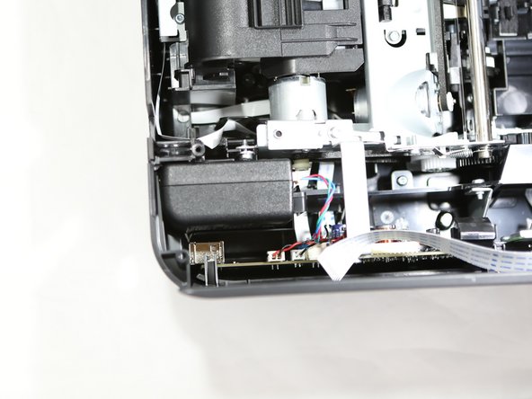

  4. HP Envy 4520 AC Adapter Replacement: crwdns2935265:04crwdnd2935265:01crwdnd2935265:02crwdne2935265:0 HP Envy 4520 AC Adapter Replacement: crwdns2935265:04crwdnd2935265:02crwdnd2935265:02crwdne2935265:0

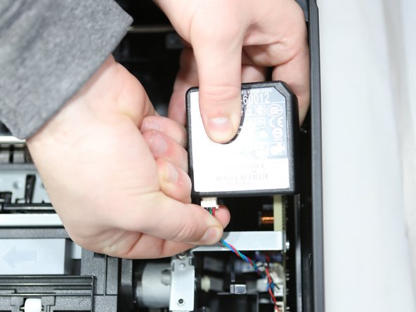

    • Locate the the AC adapter at the top left corner of the device which is connected by intertwined red and blue wires.

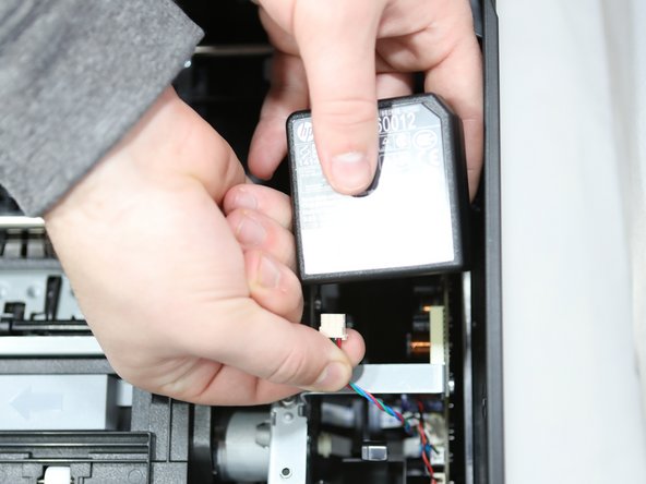

  5. HP Envy 4520 AC Adapter Replacement: crwdns2935265:05crwdnd2935265:01crwdnd2935265:03crwdne2935265:0 HP Envy 4520 AC Adapter Replacement: crwdns2935265:05crwdnd2935265:02crwdnd2935265:03crwdne2935265:0 HP Envy 4520 AC Adapter Replacement: crwdns2935265:05crwdnd2935265:03crwdnd2935265:03crwdne2935265:0
    • Remove the adapter by pinching the plastic head of the wire connector and pulling it out of the port.
