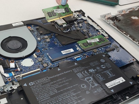

  6. HP Envy 17m-ae111dx RAM Replacement, RAM: crwdns2935265:06crwdnd2935265:01crwdnd2935265:02crwdne2935265:0 HP Envy 17m-ae111dx RAM Replacement, RAM: crwdns2935265:06crwdnd2935265:02crwdnd2935265:02crwdne2935265:0
    • Lift the two tabs on the RAM stick outwards.
    • Do not pull back directly on the RAM stick.

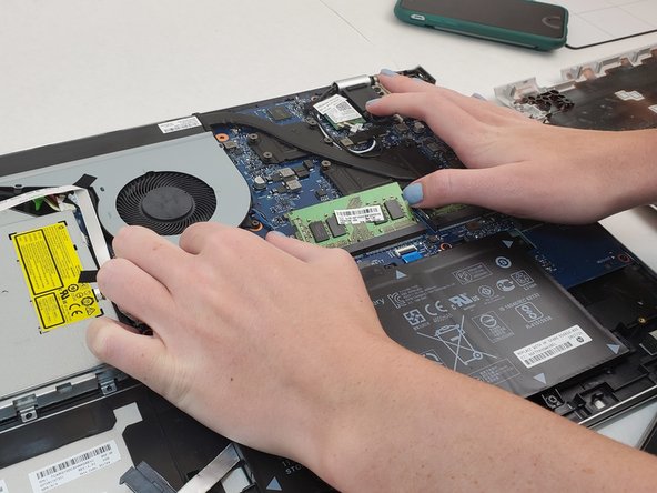

  7. HP Envy 17m-ae111dx RAM Replacement: crwdns2935265:07crwdnd2935265:01crwdnd2935265:02crwdne2935265:0 HP Envy 17m-ae111dx RAM Replacement: crwdns2935265:07crwdnd2935265:02crwdnd2935265:02crwdne2935265:0
    • Gently lift the RAM out of the socket and remove it from the device.
    • Place the new RAM stick directly into the computer by aligning the connectors into the port and pushing down lightly. It should make an audible click.
