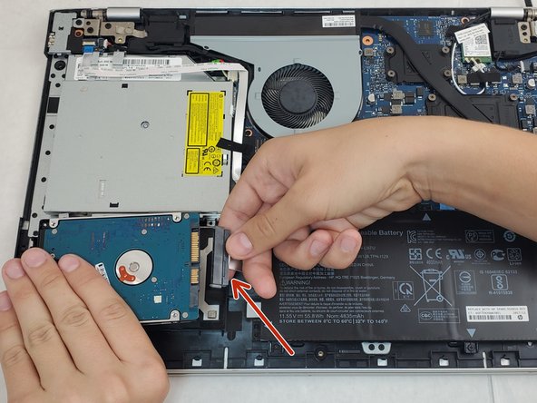

  6. HP Envy 17m-ae111dx Hard Drive Replacement, Hard Drive: crwdns2935265:06crwdnd2935265:01crwdnd2935265:03crwdne2935265:0 HP Envy 17m-ae111dx Hard Drive Replacement, Hard Drive: crwdns2935265:06crwdnd2935265:02crwdnd2935265:03crwdne2935265:0 HP Envy 17m-ae111dx Hard Drive Replacement, Hard Drive: crwdns2935265:06crwdnd2935265:03crwdnd2935265:03crwdne2935265:0
    • Unplug the cable that connects the hard drive to the motherboard.
    • Grab from the base of the cable and not from the wire.
  7. HP Envy 17m-ae111dx Hard Drive Replacement: crwdns2935265:07crwdnd2935265:01crwdnd2935265:01crwdne2935265:0
    • Remove the hard drive from the device.
