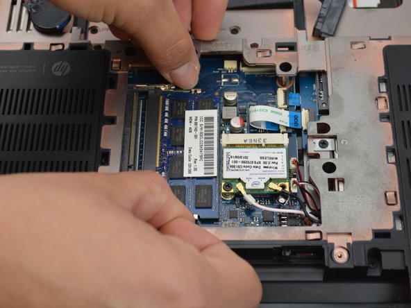

  6. HP Envy 17-J013CL Memory Module Replacement, Memory Module: crwdns2935265:06crwdnd2935265:01crwdnd2935265:02crwdne2935265:0 HP Envy 17-J013CL Memory Module Replacement, Memory Module: crwdns2935265:06crwdnd2935265:02crwdnd2935265:02crwdne2935265:0
    • Locate the memory stick inside.
  7. HP Envy 17-J013CL Memory Module Replacement: crwdns2935265:07crwdnd2935265:01crwdnd2935265:02crwdne2935265:0 HP Envy 17-J013CL Memory Module Replacement: crwdns2935265:07crwdnd2935265:02crwdnd2935265:02crwdne2935265:0
    • On both sides of the module, place a thumb on each of the metallic holding pins.
    • Gently pull on the pins to release the spring holding in the module.
  8. HP Envy 17-J013CL Memory Module Replacement: crwdns2935265:08crwdnd2935265:01crwdnd2935265:02crwdne2935265:0 HP Envy 17-J013CL Memory Module Replacement: crwdns2935265:08crwdnd2935265:02crwdnd2935265:02crwdne2935265:0
    • Gently slide the module out of the memory slot.
    • Pay in mind of the module's orientation as it will only go in one way with a little gap in the module to identify orientation.
