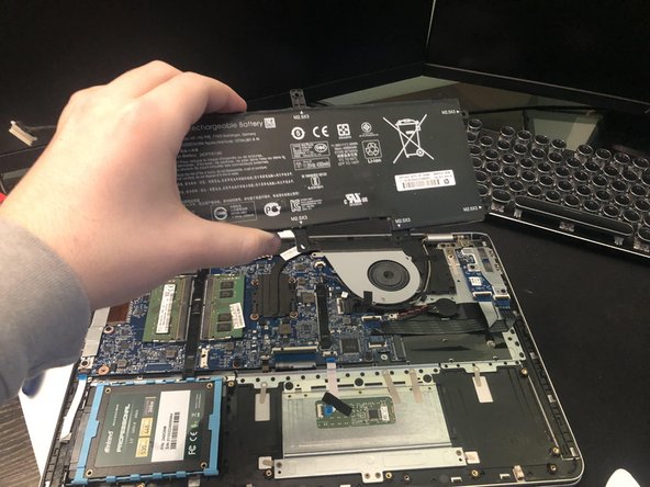

  3. HP Envy 15t-as100 Battery Replacement, Remove previous battery: crwdns2935265:03crwdnd2935265:01crwdnd2935265:02crwdne2935265:0 HP Envy 15t-as100 Battery Replacement, Remove previous battery: crwdns2935265:03crwdnd2935265:02crwdnd2935265:02crwdne2935265:0
    • Using your Philips-Head screwdriver, remove the 7 screws as shown in the picture.
    • After the screws have been removed, remove the battery from the laptop. The battery should be removed with no resistance
  4. HP Envy 15t-as100 Battery Replacement, Install new battery: crwdns2935265:04crwdnd2935265:01crwdnd2935265:02crwdne2935265:0 HP Envy 15t-as100 Battery Replacement, Install new battery: crwdns2935265:04crwdnd2935265:02crwdnd2935265:02crwdne2935265:0
    • Place the new battery into the laptop and line up the screw holes. Reinstall the battery screws.
    • Reconnect the battery cable into its connector.
