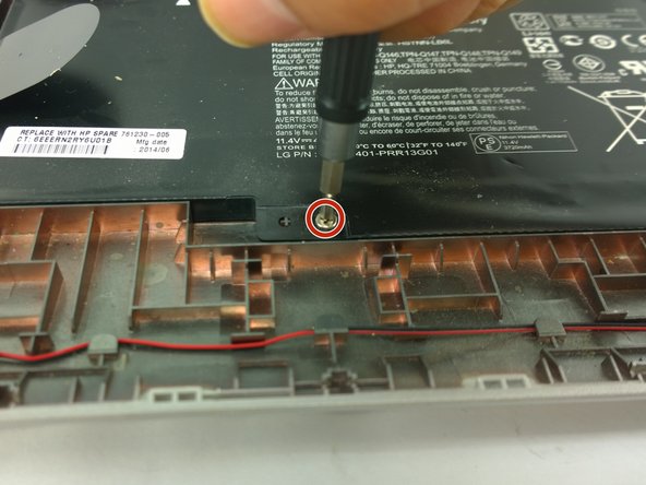

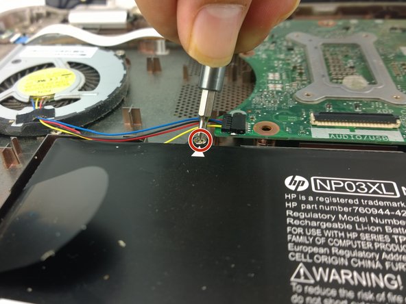

  6. HP Envy 15-u001dx Battery Replacement, Battery: crwdns2935265:06crwdnd2935265:01crwdnd2935265:03crwdne2935265:0 HP Envy 15-u001dx Battery Replacement, Battery: crwdns2935265:06crwdnd2935265:02crwdnd2935265:03crwdne2935265:0 HP Envy 15-u001dx Battery Replacement, Battery: crwdns2935265:06crwdnd2935265:03crwdnd2935265:03crwdne2935265:0
    • Remove the three 3 mm screws from the battery using Phillips #0 screwdriver.
  7. HP Envy 15-u001dx Battery Replacement: crwdns2935265:07crwdnd2935265:01crwdnd2935265:01crwdne2935265:0
    • Use a spudger to gently detach the battery connector.
    • The regular black nylon spudger should be used whenever possible, especially around sensitive internal components.
