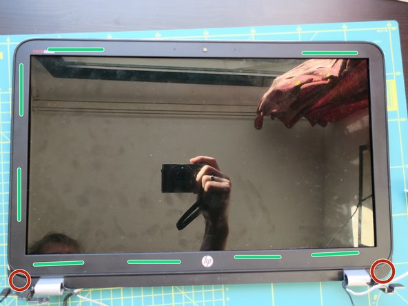

  5. HP Envy 15-J120SG Display Panel Replacement, Remove the display bezel: crwdns2935265:05crwdnd2935265:01crwdnd2935265:02crwdne2935265:0 HP Envy 15-J120SG Display Panel Replacement, Remove the display bezel: crwdns2935265:05crwdnd2935265:02crwdnd2935265:02crwdne2935265:0
    • Under the plastic of the bezel are two hidden screws: One is in the lower left corner, the other in the lower right corner. Bend the plastic up a bit and remove these screws.
    • The Bezel itself comes loose pretty easy as soon as you have disconnected it from the lower part on one point. Work your way around the display.
    • The bezel is glued to the display using double-sided tape. Be careful while lifting the plastic. When re-assembling the lid, place new double-sided tape on these places.

To reassemble your device, follow these instructions in reverse order. Take care to glue the bezel to the display on the green marked places in step 5.

Good guide but you can actually access the bottom display bezel screws in step 5 straight away.
You can remove these screws although a specific angle is required, this saves fully disassembling the laptop.
