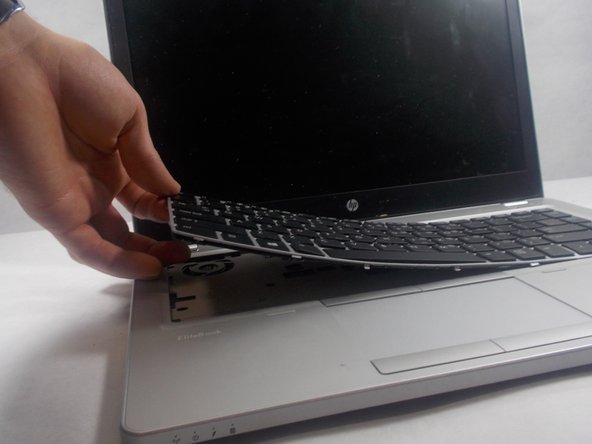

  6. HP Elitebook Folio 9470m Keyboard Replacement: crwdns2935265:06crwdnd2935265:01crwdnd2935265:03crwdne2935265:0 HP Elitebook Folio 9470m Keyboard Replacement: crwdns2935265:06crwdnd2935265:02crwdnd2935265:03crwdne2935265:0 HP Elitebook Folio 9470m Keyboard Replacement: crwdns2935265:06crwdnd2935265:03crwdnd2935265:03crwdne2935265:0
    • Flip the laptop over and locate the 2 tabs on the left or right sides. They will be slightly visible in the space between the keyboard and frame.
    • Using a plastic opening tool, push the tabs in while pulling up to disconnect the tabs from the keyboard frame.
    • Once both tabs become unclipped, lift the keyboard up gently allowing it to slightly bend as the front and back tabs come out.
  7. HP Elitebook Folio 9470m Keyboard Replacement: crwdns2935265:07crwdnd2935265:01crwdnd2935265:02crwdne2935265:0 HP Elitebook Folio 9470m Keyboard Replacement: crwdns2935265:07crwdnd2935265:02crwdnd2935265:02crwdne2935265:0
    • While lifting the keyboard up only enough to see underneath, unclip and remove the ribbon wire to fully detach the keyboard.
