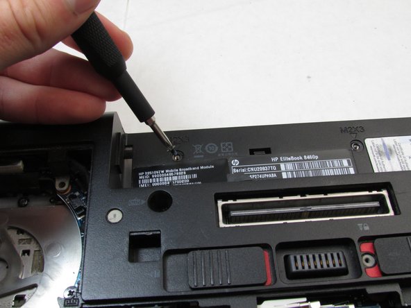

    • Using a T2 Torx screwdriver, remove the six 8.0mm Torx screws.
    • Four of the Torx screws are located on the four corners of the laptop and the other two are next to the hard drive assembly.

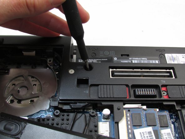

    • Using a Phillips #0 screwdriver, unscrew the Phillips screw next to the fan assembly.
  23. HP Elitebook 8460p Speaker Assembly Replacement: crwdns2935265:023crwdnd2935265:01crwdnd2935265:03crwdne2935265:0 HP Elitebook 8460p Speaker Assembly Replacement: crwdns2935265:023crwdnd2935265:02crwdnd2935265:03crwdne2935265:0 HP Elitebook 8460p Speaker Assembly Replacement: crwdns2935265:023crwdnd2935265:03crwdnd2935265:03crwdne2935265:0

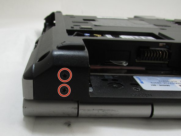

    • Using a Philips #0 screwdriver, unscrew the two Phillips screws next to the battery.
  24. HP Elitebook 8460p Speaker Assembly Replacement: crwdns2935265:024crwdnd2935265:01crwdnd2935265:02crwdne2935265:0 HP Elitebook 8460p Speaker Assembly Replacement: crwdns2935265:024crwdnd2935265:02crwdnd2935265:02crwdne2935265:0

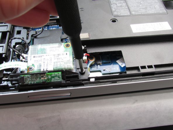

    • Using a Phillips #0 screwdriver, remove the two 3.0mm Phillips screws to the right of the optical drive slot
  26. HP Elitebook 8460p Speaker Assembly Replacement: crwdns2935265:026crwdnd2935265:01crwdnd2935265:02crwdne2935265:0 HP Elitebook 8460p Speaker Assembly Replacement: crwdns2935265:026crwdnd2935265:02crwdnd2935265:02crwdne2935265:0

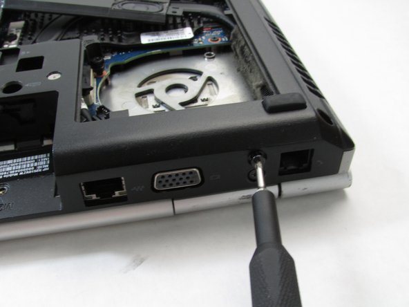

  27. HP Elitebook 8460p Speaker Assembly Replacement: crwdns2935265:027crwdnd2935265:01crwdnd2935265:03crwdne2935265:0 HP Elitebook 8460p Speaker Assembly Replacement: crwdns2935265:027crwdnd2935265:02crwdnd2935265:03crwdne2935265:0 HP Elitebook 8460p Speaker Assembly Replacement: crwdns2935265:027crwdnd2935265:03crwdnd2935265:03crwdne2935265:0

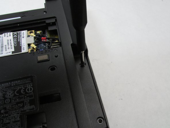

    • Using a T2 Torx screwdriver, remove the four 8.0mm Torx screws on the back side of the laptop.

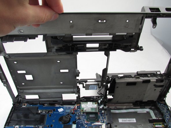

  28. HP Elitebook 8460p Speaker Assembly Replacement: crwdns2935265:028crwdnd2935265:01crwdnd2935265:03crwdne2935265:0 HP Elitebook 8460p Speaker Assembly Replacement: crwdns2935265:028crwdnd2935265:02crwdnd2935265:03crwdne2935265:0 HP Elitebook 8460p Speaker Assembly Replacement: crwdns2935265:028crwdnd2935265:03crwdnd2935265:03crwdne2935265:0
    • Using a spudger, work your way around the edge of the laptop popping the plastic chassis up.
  29. HP Elitebook 8460p Speaker Assembly Replacement: crwdns2935265:029crwdnd2935265:01crwdnd2935265:02crwdne2935265:0 HP Elitebook 8460p Speaker Assembly Replacement: crwdns2935265:029crwdnd2935265:02crwdnd2935265:02crwdne2935265:0

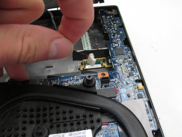

    • Lift the chassis up and detach the small connector between the hard drive and heat sink.

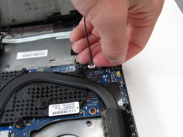

  30. HP Elitebook 8460p Speaker Assembly Replacement: crwdns2935265:030crwdnd2935265:01crwdnd2935265:03crwdne2935265:0 HP Elitebook 8460p Speaker Assembly Replacement: crwdns2935265:030crwdnd2935265:02crwdnd2935265:03crwdne2935265:0 HP Elitebook 8460p Speaker Assembly Replacement: crwdns2935265:030crwdnd2935265:03crwdnd2935265:03crwdne2935265:0
    • Disconnect the speaker connector from the motherboard.
    • Remove the old speaker assembly and connect the wire for the new speaker assembly in the same location.
