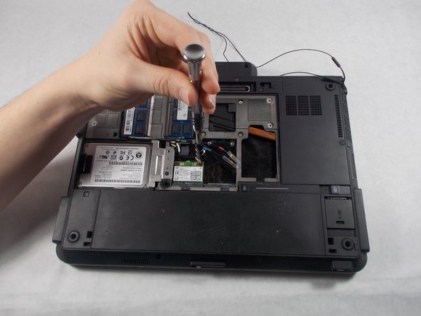

    • Place the laptop face down in front of you.
    • Use a Phillips #0 screwdriver to remove the three 3 mm screws from the back of the case.
    • Remove the back panel.

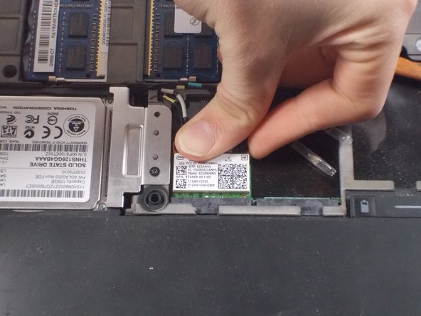

  2. HP Elitebook 2740p WI-FI  card Replacement: crwdns2935265:02crwdnd2935265:01crwdnd2935265:01crwdne2935265:0
    • Remove the two wires that are attached to the WiFi card.
  3. HP Elitebook 2740p WI-FI  card Replacement: crwdns2935265:03crwdnd2935265:01crwdnd2935265:03crwdne2935265:0 HP Elitebook 2740p WI-FI  card Replacement: crwdns2935265:03crwdnd2935265:02crwdnd2935265:03crwdne2935265:0 HP Elitebook 2740p WI-FI  card Replacement: crwdns2935265:03crwdnd2935265:03crwdnd2935265:03crwdne2935265:0
    • Use a Phillips #0 screwdriver to remove the two 3 mm Philips head screws from the WiFi card.
    • Remove the card.
