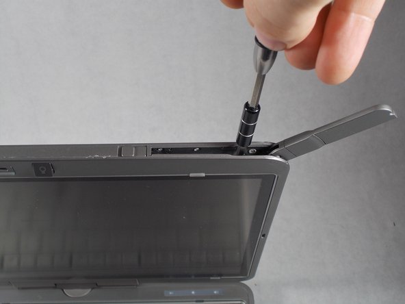

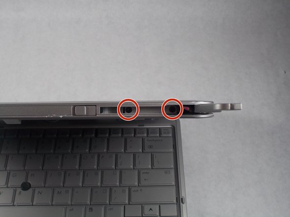

    • Locate the radio antenna on the right side of the top edge of the screen. Slide the latch to release the antenna.
    • Use a Phillips #0 screwdriver to remove the two 4 mm screws recessed in the antenna housing.

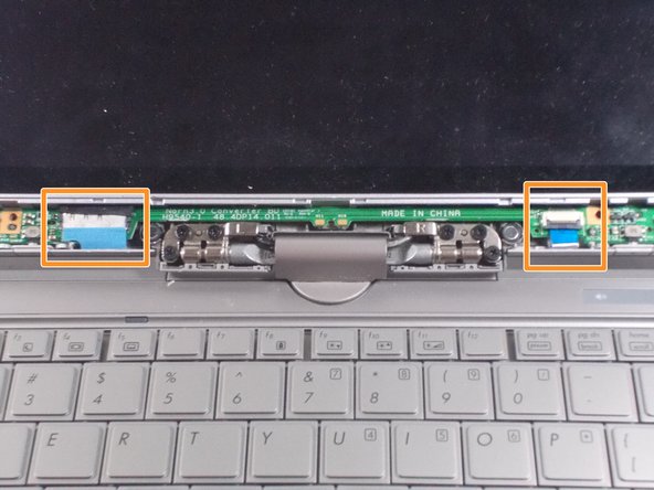

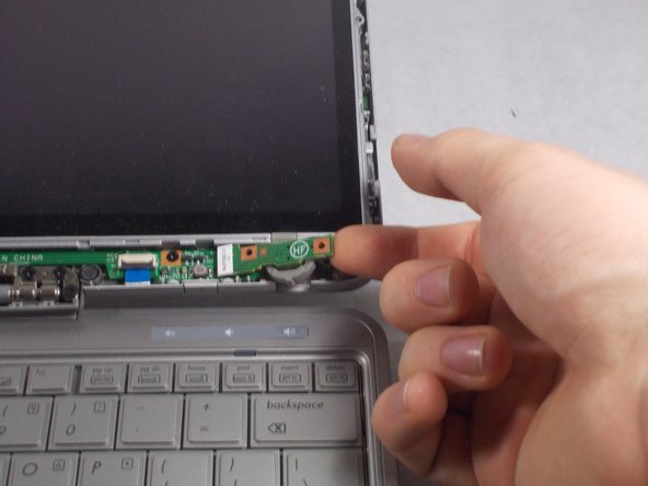

  7. HP Elitebook 2740p Screen Replacement: crwdns2935265:07crwdnd2935265:01crwdnd2935265:03crwdne2935265:0 HP Elitebook 2740p Screen Replacement: crwdns2935265:07crwdnd2935265:02crwdnd2935265:03crwdne2935265:0 HP Elitebook 2740p Screen Replacement: crwdns2935265:07crwdnd2935265:03crwdnd2935265:03crwdne2935265:0
    • Use a Phillips #0 screwdriver to remove the three screws that secure the tablet-mode button board.
    • Disconnect the two blue ribbon cables and gently pull them free.
    • Remove the PCB board from the screen housing.

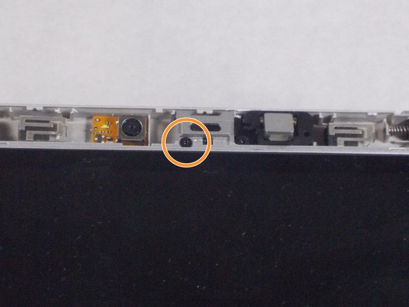

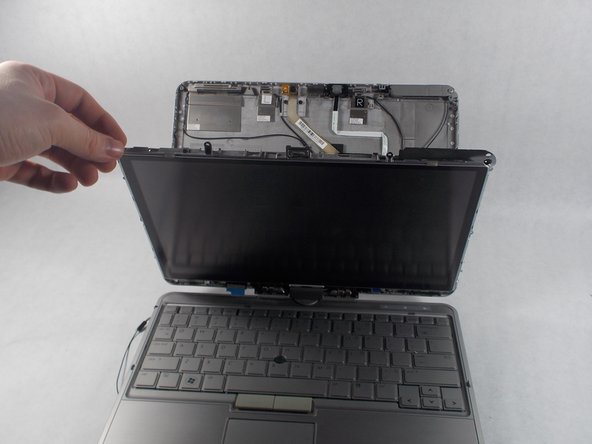

  8. HP Elitebook 2740p Screen Replacement: crwdns2935265:08crwdnd2935265:01crwdnd2935265:03crwdne2935265:0 HP Elitebook 2740p Screen Replacement: crwdns2935265:08crwdnd2935265:02crwdnd2935265:03crwdne2935265:0 HP Elitebook 2740p Screen Replacement: crwdns2935265:08crwdnd2935265:03crwdnd2935265:03crwdne2935265:0
    • Remove the gray rubber pad at the top of the screen next to the camera.
    • Remove the 3mm screw with a Phillips #0 screwdriver

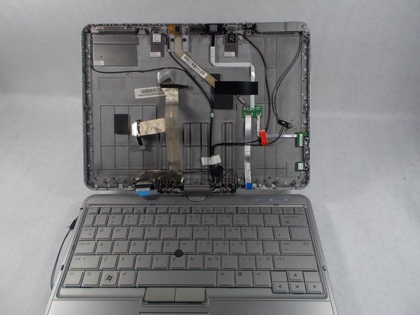

    • Carefully tilt the screen down onto the keayboard

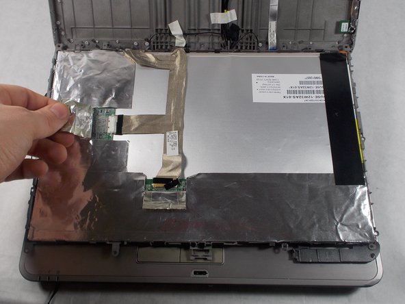

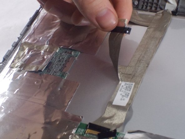

  9. HP Elitebook 2740p Screen Replacement: crwdns2935265:09crwdnd2935265:01crwdnd2935265:02crwdne2935265:0 HP Elitebook 2740p Screen Replacement: crwdns2935265:09crwdnd2935265:02crwdnd2935265:02crwdne2935265:0
    • Fold the protective foil back from the ribbon cables.
  10. HP Elitebook 2740p Screen Replacement: crwdns2935265:010crwdnd2935265:01crwdnd2935265:03crwdne2935265:0 HP Elitebook 2740p Screen Replacement: crwdns2935265:010crwdnd2935265:02crwdnd2935265:03crwdne2935265:0 HP Elitebook 2740p Screen Replacement: crwdns2935265:010crwdnd2935265:03crwdnd2935265:03crwdne2935265:0
    • Unseat display ribbon cables.
    • Ribbon cables are secured with tape. Do not force the cables out of their sockets.
    • Remove the screen.
