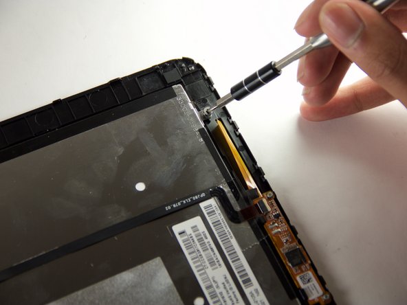

    • Unscrew the two 2.8mm Phillips #000 screws near the power connector.

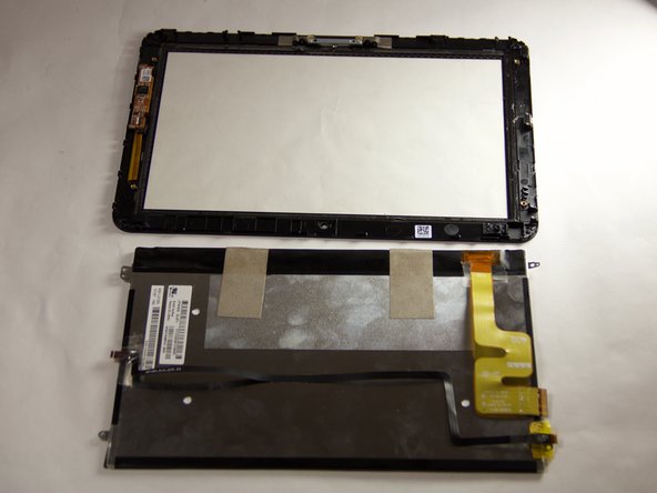

    • Use a suction cup to pull the display assembly up.
  3. HP ElitePad 900 LCD Replacement: crwdns2935265:03crwdnd2935265:01crwdnd2935265:02crwdne2935265:0 HP ElitePad 900 LCD Replacement: crwdns2935265:03crwdnd2935265:02crwdnd2935265:02crwdne2935265:0
    • Use the tip of a spudger to disconnect the two display ZIF connectors.

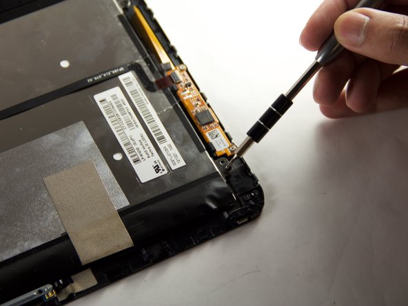

    • Remove the four 1.6mm Phillips #000 screws securing the LCD to the digitizer.

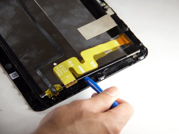

    • Use the tip of a spudger to disconnect the ribbon cable ZIF connector.
  6. HP ElitePad 900 LCD Replacement: crwdns2935265:06crwdnd2935265:01crwdnd2935265:03crwdne2935265:0 HP ElitePad 900 LCD Replacement: crwdns2935265:06crwdnd2935265:02crwdnd2935265:03crwdne2935265:0 HP ElitePad 900 LCD Replacement: crwdns2935265:06crwdnd2935265:03crwdnd2935265:03crwdne2935265:0
    • Use a plastic opening tool to separate the LCD from the digitizer.
