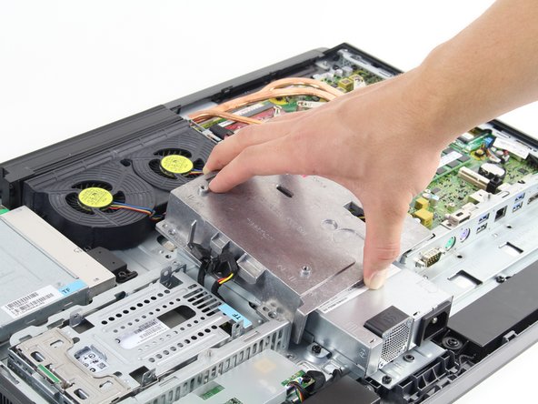

  6. HP EliteOne 800 G1 Power Supply Replacement: crwdns2935265:06crwdnd2935265:01crwdnd2935265:01crwdne2935265:0
    • Disconnect the power supply's black and yellow cable from the motherboard.
  7. HP EliteOne 800 G1 Power Supply Replacement: crwdns2935265:07crwdnd2935265:01crwdnd2935265:02crwdne2935265:0 HP EliteOne 800 G1 Power Supply Replacement: crwdns2935265:07crwdnd2935265:02crwdnd2935265:02crwdne2935265:0
    • Use a Torx T15 driver to remove the two 8mm screws on either side of the power supply.
    • Lift the power supply from the case to remove it.
