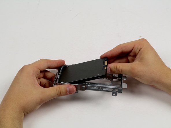

  3. HP EliteOne 800 G1 Hard Disk Drive / Solid State Drive Replacement: crwdns2935265:03crwdnd2935265:01crwdnd2935265:02crwdne2935265:0 HP EliteOne 800 G1 Hard Disk Drive / Solid State Drive Replacement: crwdns2935265:03crwdnd2935265:02crwdnd2935265:02crwdne2935265:0
    • Once the cage is out of the device, use a Torx T15 driver to unscrew the four 10mm screws keeping the drive in place. There are two screws on each side.
    • Once all the screws are removed, lift the drive out of the cage.
