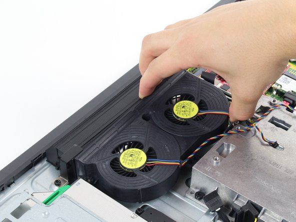

  5. HP EliteOne 800 G1 Fan Assembly Replacement, Fan Assembly: crwdns2935265:05crwdnd2935265:01crwdnd2935265:01crwdne2935265:0
    • Disconnect these two power connectors on the motherboard, one connector is white and the other is black. You can identify the correct wires by their braided colors: red, yellow, blue, and black.
  6. HP EliteOne 800 G1 Fan Assembly Replacement: crwdns2935265:06crwdnd2935265:01crwdnd2935265:02crwdne2935265:0 HP EliteOne 800 G1 Fan Assembly Replacement: crwdns2935265:06crwdnd2935265:02crwdnd2935265:02crwdne2935265:0
    • Use a Torx T15 driver to remove the three 6mm screws surrounding the fan assembly.
    • Pull the fan assembly up from the case to remove it.
