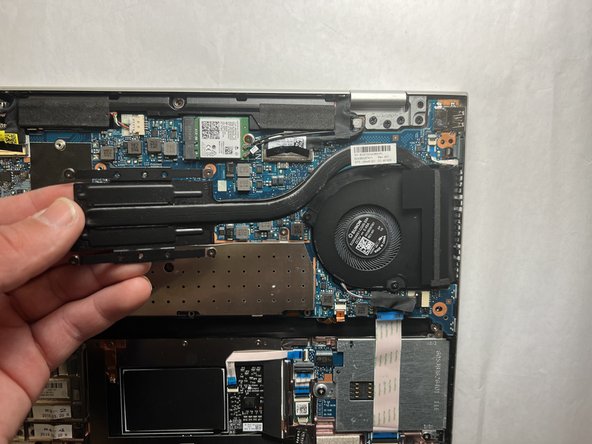

  6. HP EliteBook x360 830 G6 Heatsink Replacement, Heatsink: crwdns2935265:06crwdnd2935265:01crwdnd2935265:01crwdne2935265:0
    • Use a Phillips #0 screwdriver to remove each of the four 3 mm screws at each corner of the heatsink.

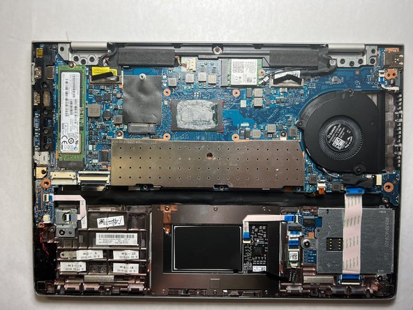

  7. HP EliteBook x360 830 G6 Heatsink Replacement: crwdns2935265:07crwdnd2935265:01crwdnd2935265:03crwdne2935265:0 HP EliteBook x360 830 G6 Heatsink Replacement: crwdns2935265:07crwdnd2935265:02crwdnd2935265:03crwdne2935265:0 HP EliteBook x360 830 G6 Heatsink Replacement: crwdns2935265:07crwdnd2935265:03crwdnd2935265:03crwdne2935265:0
    • Gently pull the heatsink off of the motherboard.
    • Be sure to clean the old thermal paste and apply new thermal paste before replacing the heatsink.
    • Tighten the replacement heatsink screws in an "X" pattern.
