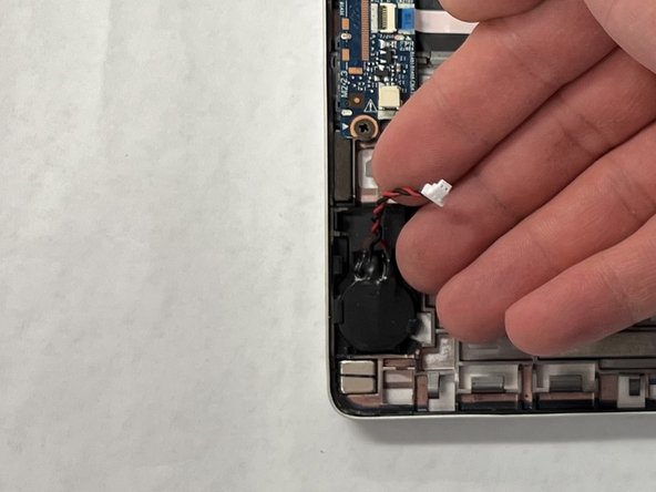

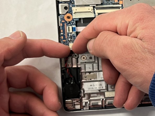

  6. HP EliteBook x360 830 G6 CMOS Battery Replacement, CMOS Battery: crwdns2935265:06crwdnd2935265:01crwdnd2935265:03crwdne2935265:0 HP EliteBook x360 830 G6 CMOS Battery Replacement, CMOS Battery: crwdns2935265:06crwdnd2935265:02crwdnd2935265:03crwdne2935265:0 HP EliteBook x360 830 G6 CMOS Battery Replacement, CMOS Battery: crwdns2935265:06crwdnd2935265:03crwdnd2935265:03crwdne2935265:0
    • Use your fingers or the pointed end of a spudger disconnect the CMOS battery connector.
  7. HP EliteBook x360 830 G6 CMOS Battery Replacement: crwdns2935265:07crwdnd2935265:01crwdnd2935265:01crwdne2935265:0
    • Remove the CMOS battery from its housing by pulling up the small, black plastic tab that is holding it in place.
