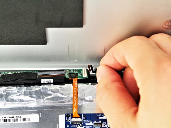

  3. HP EliteBook x360 1030 G3 Screen Replacement: crwdns2935265:03crwdnd2935265:01crwdnd2935265:02crwdne2935265:0 HP EliteBook x360 1030 G3 Screen Replacement: crwdns2935265:03crwdnd2935265:02crwdnd2935265:02crwdne2935265:0
    • Pull the tape off the gold wire port on the left.
  4. HP EliteBook x360 1030 G3 Screen Replacement: crwdns2935265:04crwdnd2935265:01crwdnd2935265:02crwdne2935265:0 HP EliteBook x360 1030 G3 Screen Replacement: crwdns2935265:04crwdnd2935265:02crwdnd2935265:02crwdne2935265:0
    • There is a thin hinged bar hugging the front of the port to keep the wire housing in place. Use your nail or a thin object to lift it up and out of the way.
    • Use the hinged bar to slide the wire housing away from you and out of the port.
  5. HP EliteBook x360 1030 G3 Screen Replacement: crwdns2935265:05crwdnd2935265:01crwdnd2935265:02crwdne2935265:0 HP EliteBook x360 1030 G3 Screen Replacement: crwdns2935265:05crwdnd2935265:02crwdnd2935265:02crwdne2935265:0
    • Locate the collection of ports on the right.
    • Pull the tape from the port with the thicker orange sheet of wires and from the port on the small green circuit board.
  6. HP EliteBook x360 1030 G3 Screen Replacement: crwdns2935265:06crwdnd2935265:01crwdnd2935265:02crwdne2935265:0 HP EliteBook x360 1030 G3 Screen Replacement: crwdns2935265:06crwdnd2935265:02crwdnd2935265:02crwdne2935265:0
    • Use your nail or a thin object to lift the small white fastener at the front of the port.
    • Slide the orange sheet away from you out of the port.
  7. HP EliteBook x360 1030 G3 Screen Replacement: crwdns2935265:07crwdnd2935265:01crwdnd2935265:03crwdne2935265:0 HP EliteBook x360 1030 G3 Screen Replacement: crwdns2935265:07crwdnd2935265:02crwdnd2935265:03crwdne2935265:0 HP EliteBook x360 1030 G3 Screen Replacement: crwdns2935265:07crwdnd2935265:03crwdnd2935265:03crwdne2935265:0
    • Use your nail or a thin object to lift the small white fastener at end of the port on the green circuit board.
    • Slide the sheet of wires to the right and out of the port.
    • Carefully lift, and remove the screen.

I tried to perform this operation, since the top cover got a scratch and a ding. I bought a replacement top cover and tried to reinstall a perfectly working screen from one cover to another. I followed this manual to step 2 and realized that top is easy, sides are much harder. On the sides with the opener tool you start to touch directly the screen glass so the “slowly twist“ move suggested in this manual would likely create cracks in it. Finally I decided not to execute this procedure since the risk of losing the screen is too high. In case you replace a broken screen - then it is ok.
