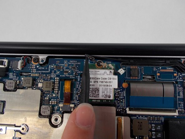

  3. HP EliteBook Folio 1020 G1 Wi-Fi Card Replacement, Wi-Fi Card: crwdns2935265:03crwdnd2935265:01crwdnd2935265:02crwdne2935265:0 HP EliteBook Folio 1020 G1 Wi-Fi Card Replacement, Wi-Fi Card: crwdns2935265:03crwdnd2935265:02crwdnd2935265:02crwdne2935265:0
    • Disconnect the two coaxial cables connected to the card.
    • Be sure to remember which wire is which. It is easy to get these wires mixed up.
  4. HP EliteBook Folio 1020 G1 Wi-Fi Card Replacement: crwdns2935265:04crwdnd2935265:01crwdnd2935265:01crwdne2935265:0
    • Use a Phillips #1 screwdriver to unscrew and remove the single 1.8 mm screw that secures the card to the board.
  5. HP EliteBook Folio 1020 G1 Wi-Fi Card Replacement: crwdns2935265:05crwdnd2935265:01crwdnd2935265:01crwdne2935265:0
    • Lift the card slightly and then pull away from the port and remove.
