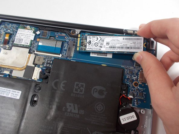

  3. HP EliteBook Folio 1020 G1 Solid State Drive Replacement, Solid State Drive: crwdns2935265:03crwdnd2935265:01crwdnd2935265:01crwdne2935265:0
    • Use a Phillips #1 screwdriver to remove the single 1.8 mm screw that secures the SSD to the board.
  4. HP EliteBook Folio 1020 G1 Solid State Drive Replacement: crwdns2935265:04crwdnd2935265:01crwdnd2935265:02crwdne2935265:0 HP EliteBook Folio 1020 G1 Solid State Drive Replacement: crwdns2935265:04crwdnd2935265:02crwdnd2935265:02crwdne2935265:0
    • Lift the SSD slightly and then pull away from the port and remove.
