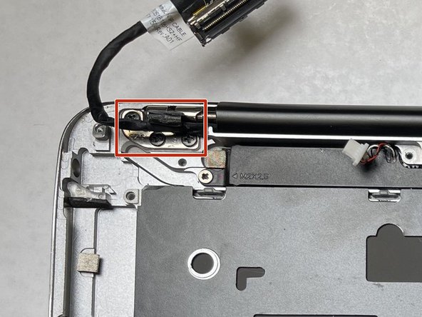

  11. HP EliteBook Folio 1020 G1 Display Replacement, Display: crwdns2935265:011crwdnd2935265:01crwdnd2935265:03crwdne2935265:0 HP EliteBook Folio 1020 G1 Display Replacement, Display: crwdns2935265:011crwdnd2935265:02crwdnd2935265:03crwdne2935265:0 HP EliteBook Folio 1020 G1 Display Replacement, Display: crwdns2935265:011crwdnd2935265:03crwdnd2935265:03crwdne2935265:0
    • To release the display frame from the lower frame, remove:
    • Six 4.1 mm screws using Phillips #0.
  12. HP EliteBook Folio 1020 G1 Display Replacement: crwdns2935265:012crwdnd2935265:01crwdnd2935265:02crwdne2935265:0 HP EliteBook Folio 1020 G1 Display Replacement: crwdns2935265:012crwdnd2935265:02crwdnd2935265:02crwdne2935265:0
    • Once the screen is separated from the bottom frame, use a plastic opening tool to remove the bottom trim from the screen.
  13. HP EliteBook Folio 1020 G1 Display Replacement: crwdns2935265:013crwdnd2935265:01crwdnd2935265:02crwdne2935265:0 HP EliteBook Folio 1020 G1 Display Replacement: crwdns2935265:013crwdnd2935265:02crwdnd2935265:02crwdne2935265:0
    • Using the iOpener and spudger, work around the screen bezel to remove it.
  14. HP EliteBook Folio 1020 G1 Display Replacement: crwdns2935265:014crwdnd2935265:01crwdnd2935265:02crwdne2935265:0 HP EliteBook Folio 1020 G1 Display Replacement: crwdns2935265:014crwdnd2935265:02crwdnd2935265:02crwdne2935265:0
    • To remove the screen, remove:
    • Four 2.2 mm screws using Phillips #0.
  15. HP EliteBook Folio 1020 G1 Display Replacement: crwdns2935265:015crwdnd2935265:01crwdnd2935265:01crwdne2935265:0
    • Lift display from the frame.
