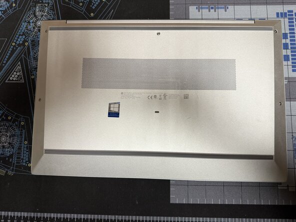

    • To start flip the device so the bottom is facing up
  2. HP EliteBook 850 G7 SSD Replacement: crwdns2935265:02crwdnd2935265:01crwdnd2935265:02crwdne2935265:0 HP EliteBook 850 G7 SSD Replacement: crwdns2935265:02crwdnd2935265:02crwdnd2935265:02crwdne2935265:0

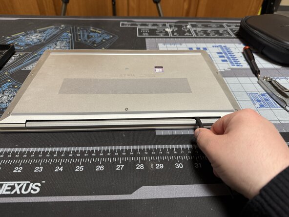

    • Unscrew the 5 marked captive screws with a Phillips #1 and flip the device so the hinge is faced towards you
    • Slide a spudger under the shell to pop the clips and run it around the perimeter of the shell until you can remove it.

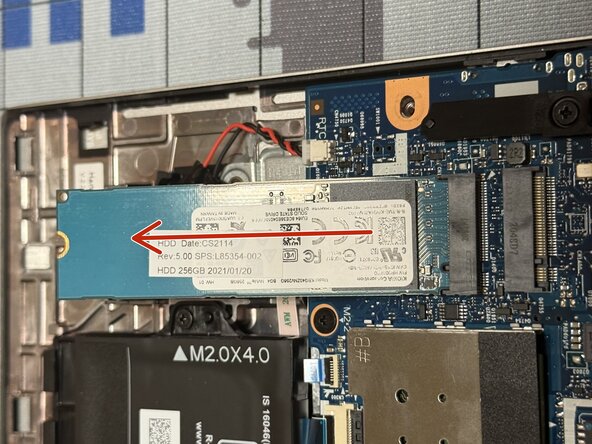

    • Unscrew the marked screw
    • Pull the SSD out in the marked direction
    • It can be replaced with most NVME 2280 SSDs
