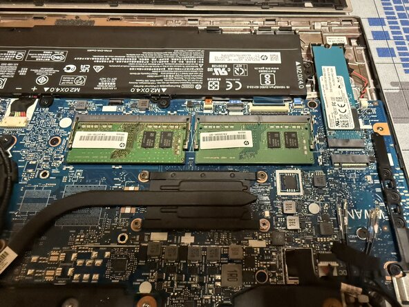

    • To start flip the device so the bottom is facing up
  2. HP EliteBook 850 G7 RAM Replacement: crwdns2935265:02crwdnd2935265:01crwdnd2935265:02crwdne2935265:0 HP EliteBook 850 G7 RAM Replacement: crwdns2935265:02crwdnd2935265:02crwdnd2935265:02crwdne2935265:0

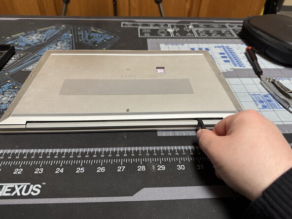

    • Unscrew the 5 marked captive screws with a Phillips #1 and flip the device so the hinge is faced towards you
    • Slide a spudger under the shell to pop the clips and run it around the perimeter of the shell until you can remove it.
  3. HP EliteBook 850 G7 RAM Replacement: crwdns2935265:03crwdnd2935265:01crwdnd2935265:03crwdne2935265:0 HP EliteBook 850 G7 RAM Replacement: crwdns2935265:03crwdnd2935265:02crwdnd2935265:03crwdne2935265:0 HP EliteBook 850 G7 RAM Replacement: crwdns2935265:03crwdnd2935265:03crwdnd2935265:03crwdne2935265:0

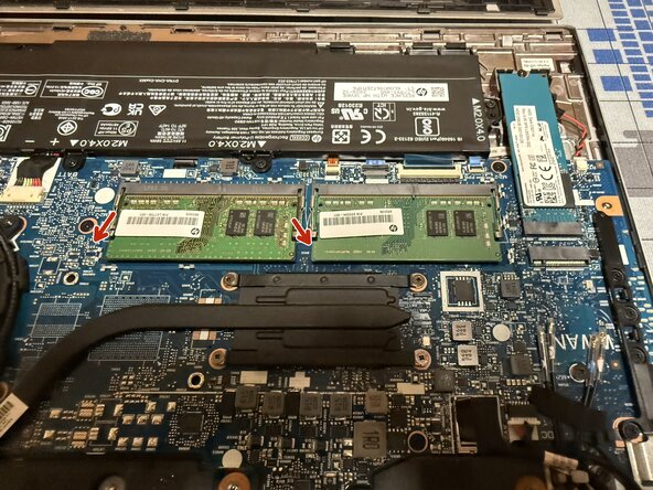

    • Lift directly up on the marked tab to remove the shielding
    • The RAM is now exposed.
    • When reassembling make sure to realign the sides of the shielding with the clips on the motherboard
    • The new RAM can be inserted and clipped down as shown.
    • For reference the 850 G7 uses DDR4 SODIMMs
