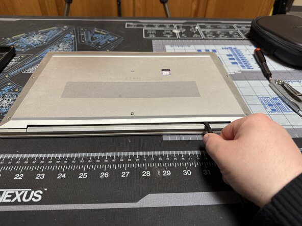

    • To start flip the device so the bottom is facing up
  2. HP EliteBook 850 G7 Battery Replacement: crwdns2935265:02crwdnd2935265:01crwdnd2935265:02crwdne2935265:0 HP EliteBook 850 G7 Battery Replacement: crwdns2935265:02crwdnd2935265:02crwdnd2935265:02crwdne2935265:0
    • Unscrew the 5 marked captive screws with a Phillips #1 and flip the device so the hinge is faced towards you
    • Slide a spudger under the shell to pop the clips and run it around the perimeter of the shell until you can remove it.
  3. HP EliteBook 850 G7 Battery Replacement: crwdns2935265:03crwdnd2935265:01crwdnd2935265:02crwdne2935265:0 HP EliteBook 850 G7 Battery Replacement: crwdns2935265:03crwdnd2935265:02crwdnd2935265:02crwdne2935265:0
    • Unplug the battery cable
    • Then remove the 4 marked screws.
    • The battery can now be removed
    • For reassembly just follow the directions in reverse
