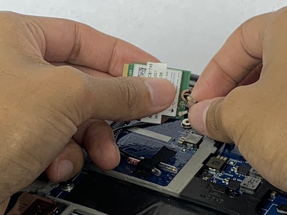

HP EliteBook 850 G3 WiFi Card Replacement
  1. HP EliteBook 850 G3 WiFi Card Replacement, WiFi Card: crwdns2935265:01crwdnd2935265:01crwdnd2935265:01crwdne2935265:0
    • Turn off your laptop before starting
    • Flip the laptop over so the model stickers face the ceiling.
  2. HP EliteBook 850 G3 WiFi Card Replacement: crwdns2935265:02crwdnd2935265:01crwdnd2935265:02crwdne2935265:0 HP EliteBook 850 G3 WiFi Card Replacement: crwdns2935265:02crwdnd2935265:02crwdnd2935265:02crwdne2935265:0
    • Use a Phillips #0 screwdriver to remove eleven 5.7mm screws.
  3. HP EliteBook 850 G3 WiFi Card Replacement: crwdns2935265:03crwdnd2935265:01crwdnd2935265:02crwdne2935265:0 HP EliteBook 850 G3 WiFi Card Replacement: crwdns2935265:03crwdnd2935265:02crwdnd2935265:02crwdne2935265:0
    • Insert the iFixit opening pick underneath the plastic back of the laptop. Use force to pry back off.
  4. HP EliteBook 850 G3 WiFi Card Replacement: crwdns2935265:04crwdnd2935265:01crwdnd2935265:01crwdne2935265:0
    • Use the Phillips #0 screwdriver to remove the 3.3mm screw on the WiFi card.
  5. HP EliteBook 850 G3 WiFi Card Replacement: crwdns2935265:05crwdnd2935265:01crwdnd2935265:02crwdne2935265:0 HP EliteBook 850 G3 WiFi Card Replacement: crwdns2935265:05crwdnd2935265:02crwdnd2935265:02crwdne2935265:0
    • Slide out the WiFi card.

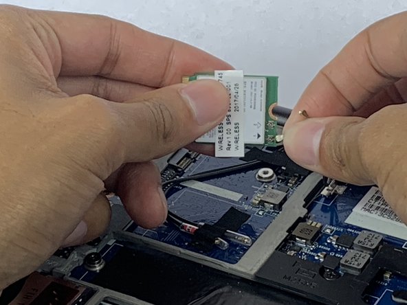

  6. HP EliteBook 850 G3 WiFi Card Replacement: crwdns2935265:06crwdnd2935265:01crwdnd2935265:03crwdne2935265:0 HP EliteBook 850 G3 WiFi Card Replacement: crwdns2935265:06crwdnd2935265:02crwdnd2935265:03crwdne2935265:0 HP EliteBook 850 G3 WiFi Card Replacement: crwdns2935265:06crwdnd2935265:03crwdnd2935265:03crwdne2935265:0
    • Disconnect the coaxial cables wires from the WiFi card.

Thank you, my HP Elitebook 850 G3 had a faulty WiFi module, it would only turn on for a second and turn off all the time in Windows 10. Tried everything inc latest drivers and clean W10 install. This guide made it easier than I thought. Replaced WiFi module with a new ordered spare and it works perfectly now.
