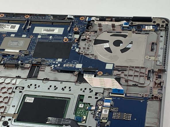

  11. HP EliteBook 850 G3 Motherboard Replacement: crwdns2935265:012crwdnd2935265:01crwdnd2935265:01crwdne2935265:0
    • Use a #00 Phillips screwdriver to remove twelve 5.7 mm screws from the motherboard.
  12. HP EliteBook 850 G3 Motherboard Replacement: crwdns2935265:013crwdnd2935265:01crwdnd2935265:03crwdne2935265:0 HP EliteBook 850 G3 Motherboard Replacement: crwdns2935265:013crwdnd2935265:02crwdnd2935265:03crwdne2935265:0 HP EliteBook 850 G3 Motherboard Replacement: crwdns2935265:013crwdnd2935265:03crwdnd2935265:03crwdne2935265:0
    • Remove the wire connectors.

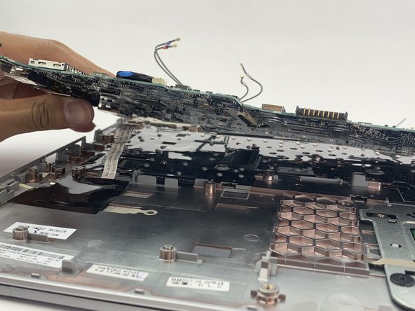

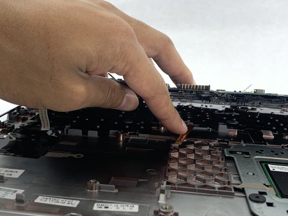

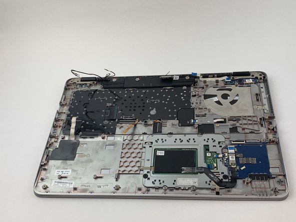

    • Jiggle the motherboard until the ports (ie. headphone jack) come out from the sides and you can lift it up.
  14. HP EliteBook 850 G3 Motherboard Replacement: crwdns2935265:015crwdnd2935265:01crwdnd2935265:03crwdne2935265:0 HP EliteBook 850 G3 Motherboard Replacement: crwdns2935265:015crwdnd2935265:02crwdnd2935265:03crwdne2935265:0 HP EliteBook 850 G3 Motherboard Replacement: crwdns2935265:015crwdnd2935265:03crwdnd2935265:03crwdne2935265:0

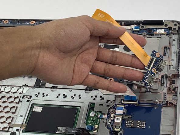

    • Disconnect the wires underneath.
  15. HP EliteBook 850 G3 Motherboard Replacement: crwdns2935265:016crwdnd2935265:01crwdnd2935265:03crwdne2935265:0 HP EliteBook 850 G3 Motherboard Replacement: crwdns2935265:016crwdnd2935265:02crwdnd2935265:03crwdne2935265:0 HP EliteBook 850 G3 Motherboard Replacement: crwdns2935265:016crwdnd2935265:03crwdnd2935265:03crwdne2935265:0
    • Take out the motherboard.
