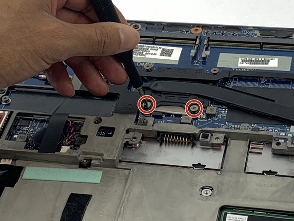

  4. HP EliteBook 850 G3 Fan Replacement, Remove the battery screws: crwdns2935265:04crwdnd2935265:01crwdnd2935265:02crwdne2935265:0 HP EliteBook 850 G3 Fan Replacement, Remove the battery screws: crwdns2935265:04crwdnd2935265:02crwdnd2935265:02crwdne2935265:0
    • Use the Phillips #0 screwdriver to remove the two battery screws.
    • The two battery screws are captured screws and do not come out.
  5. HP EliteBook 850 G3 Fan Replacement, Lift the battery: crwdns2935265:05crwdnd2935265:01crwdnd2935265:03crwdne2935265:0 HP EliteBook 850 G3 Fan Replacement, Lift the battery: crwdns2935265:05crwdnd2935265:02crwdnd2935265:03crwdne2935265:0 HP EliteBook 850 G3 Fan Replacement, Lift the battery: crwdns2935265:05crwdnd2935265:03crwdnd2935265:03crwdne2935265:0
    • Lift and pull the flap located at the top of the battery to remove it.

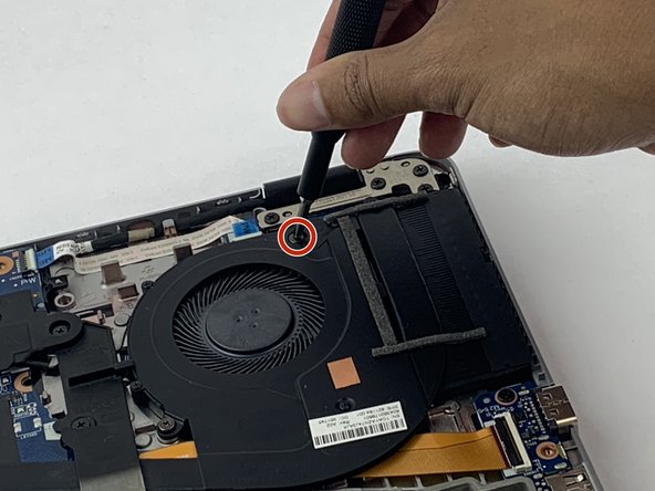

  7. HP EliteBook 850 G3 Fan Replacement: crwdns2935265:07crwdnd2935265:01crwdnd2935265:03crwdne2935265:0 HP EliteBook 850 G3 Fan Replacement: crwdns2935265:07crwdnd2935265:02crwdnd2935265:03crwdne2935265:0 HP EliteBook 850 G3 Fan Replacement: crwdns2935265:07crwdnd2935265:03crwdnd2935265:03crwdne2935265:0
    • Use a Phillips #0 screwdriver to unscrew the four captive screws located near the fan and heatsink assembly.

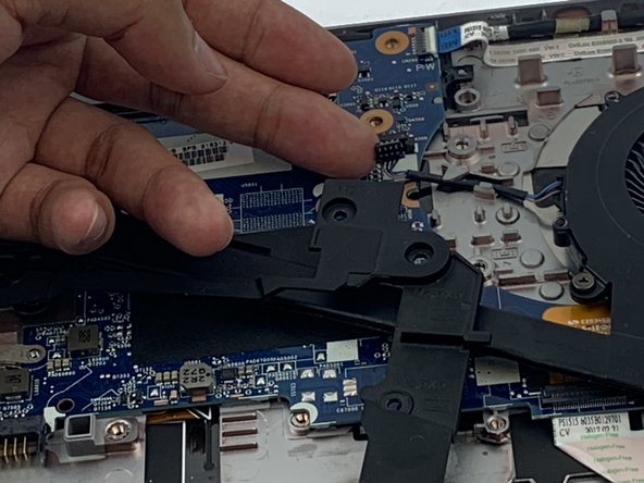

  8. HP EliteBook 850 G3 Fan Replacement: crwdns2935265:08crwdnd2935265:01crwdnd2935265:02crwdne2935265:0 HP EliteBook 850 G3 Fan Replacement: crwdns2935265:08crwdnd2935265:02crwdnd2935265:02crwdne2935265:0
    • Carefully remove the connector for the fan.

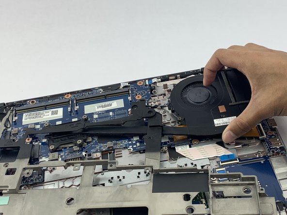

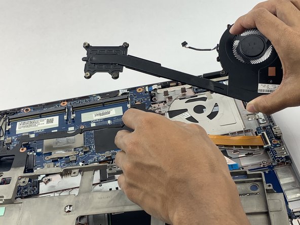

  9. HP EliteBook 850 G3 Fan Replacement: crwdns2935265:09crwdnd2935265:01crwdnd2935265:03crwdne2935265:0 HP EliteBook 850 G3 Fan Replacement: crwdns2935265:09crwdnd2935265:02crwdnd2935265:03crwdne2935265:0 HP EliteBook 850 G3 Fan Replacement: crwdns2935265:09crwdnd2935265:03crwdnd2935265:03crwdne2935265:0
    • Carefully remove the fan and heatsink assembly from the laptop.
