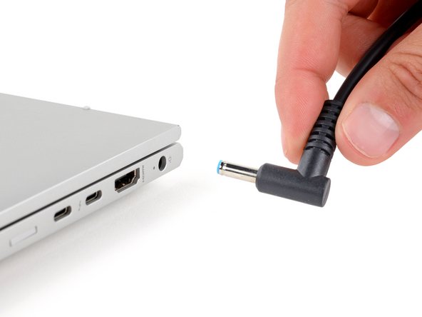

    • Before starting your repair, save your work, fully shut down your laptop, and unplug all cables.
