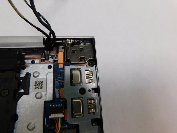

    • Pull away on the connector to remove.
  17. HP EliteBook 840 G7 keyboard Replacement: crwdns2935265:017crwdnd2935265:01crwdnd2935265:03crwdne2935265:0 HP EliteBook 840 G7 keyboard Replacement: crwdns2935265:017crwdnd2935265:02crwdnd2935265:03crwdne2935265:0 HP EliteBook 840 G7 keyboard Replacement: crwdns2935265:017crwdnd2935265:03crwdnd2935265:03crwdne2935265:0
    • Use your Phillips #1 screwdriver to remove the three 1.3 mm screws.
    • Lift up and away to remove the USB ports.

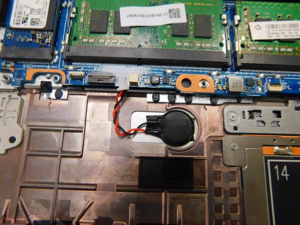

    • Pull on the bundled connector to remove.
    • After removing the connector pull off the CMOS battery.

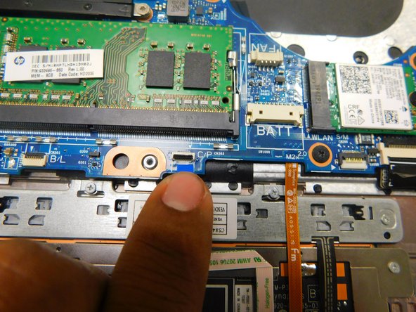

    • Lift on the latch on the ZIF connector.
    • Pull on the cable to remove.
  23. HP EliteBook 840 G7 keyboard Replacement: crwdns2935265:023crwdnd2935265:01crwdnd2935265:03crwdne2935265:0 HP EliteBook 840 G7 keyboard Replacement: crwdns2935265:023crwdnd2935265:02crwdnd2935265:03crwdne2935265:0 HP EliteBook 840 G7 keyboard Replacement: crwdns2935265:023crwdnd2935265:03crwdnd2935265:03crwdne2935265:0
    • Release the latch on the ZIF connector.
    • Carefully pull the connector to remove.

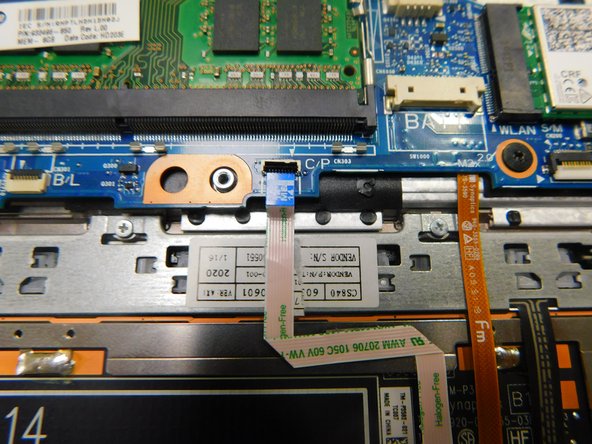

    • Lift the latch on the ZIF connector.
  26. HP EliteBook 840 G7 keyboard Replacement: crwdns2935265:026crwdnd2935265:01crwdnd2935265:03crwdne2935265:0 HP EliteBook 840 G7 keyboard Replacement: crwdns2935265:026crwdnd2935265:02crwdnd2935265:03crwdne2935265:0 HP EliteBook 840 G7 keyboard Replacement: crwdns2935265:026crwdnd2935265:03crwdnd2935265:03crwdne2935265:0

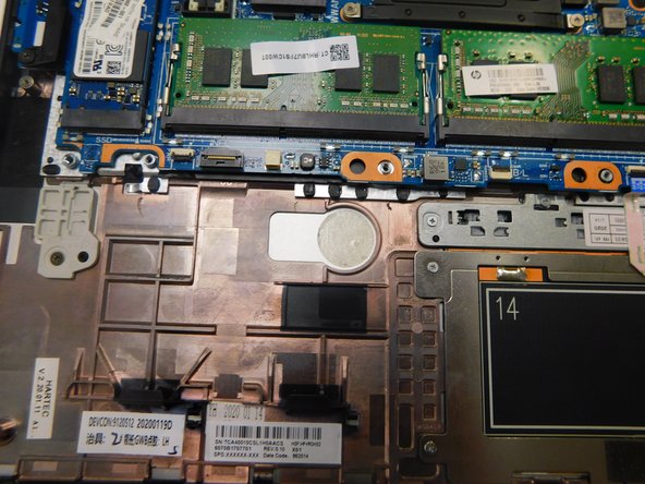

Donc ce tuto permet de tout enlever sauf le clavier?
Pilc - crwdns2934203:0crwdne2934203:0
This is only replacement of the touchpad?
Where is the keyboard replacement?
Koehoe22 - crwdns2934203:0crwdne2934203:0
the keyboard is part of the top shell and is rivetted in, you need to replace the whole part
