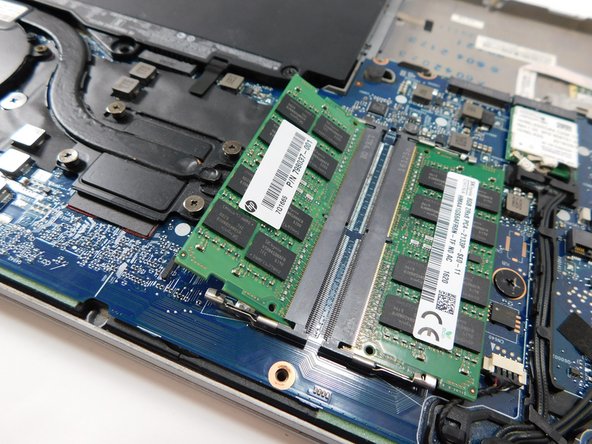

  3. HP EliteBook 820 G3 RAM Replacement, RAM: crwdns2935265:03crwdnd2935265:01crwdnd2935265:03crwdne2935265:0 HP EliteBook 820 G3 RAM Replacement, RAM: crwdns2935265:03crwdnd2935265:02crwdnd2935265:03crwdne2935265:0 HP EliteBook 820 G3 RAM Replacement, RAM: crwdns2935265:03crwdnd2935265:03crwdnd2935265:03crwdne2935265:0
    • Pull the two clips on either side of the RAM sideways at the same time.
    • The top half of the stick will pop out of its plate.
    • Pull the RAM stick out.
    • Repeat this step with the other RAM stick.
