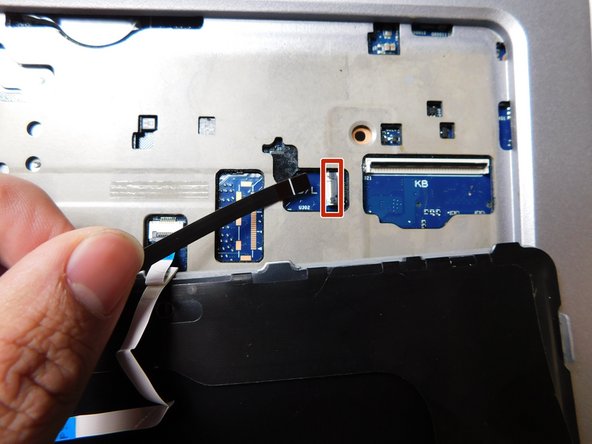

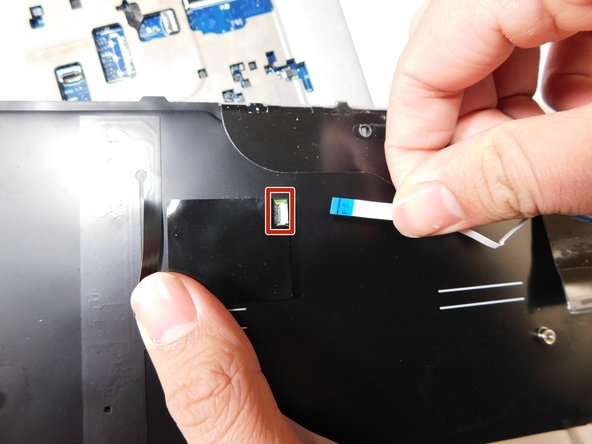

  4. HP EliteBook 820 G3 Keyboard Replacement: crwdns2935265:04crwdnd2935265:01crwdnd2935265:03crwdne2935265:0 HP EliteBook 820 G3 Keyboard Replacement: crwdns2935265:04crwdnd2935265:02crwdnd2935265:03crwdne2935265:0 HP EliteBook 820 G3 Keyboard Replacement: crwdns2935265:04crwdnd2935265:03crwdnd2935265:03crwdne2935265:0
    • Use an iFixit opening pick to gently pry open the top of the keyboard.
    • Gently pull the keyboard up until you can see the three ribbons under the keyboard.
  5. HP EliteBook 820 G3 Keyboard Replacement: crwdns2935265:05crwdnd2935265:01crwdnd2935265:03crwdne2935265:0 HP EliteBook 820 G3 Keyboard Replacement: crwdns2935265:05crwdnd2935265:02crwdnd2935265:03crwdne2935265:0 HP EliteBook 820 G3 Keyboard Replacement: crwdns2935265:05crwdnd2935265:03crwdnd2935265:03crwdne2935265:0
    • Lift up the latch holding down the ribbon and pull the ribbon out once it is lifted.
    • Repeat for all three of the ribbons.
    • The white ribbon (left ribbon) sometimes does not come with a new keyboard. You may need to detach it and add it to the replacement if necessary.
