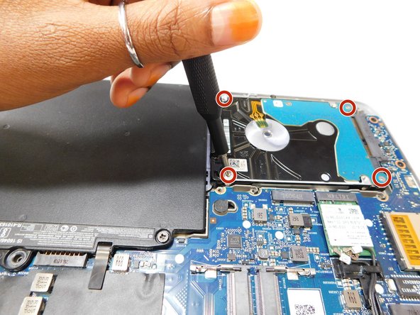

  3. HP EliteBook 820 G3 Hard Drive Replacement, Hard Drive: crwdns2935265:03crwdnd2935265:01crwdnd2935265:02crwdne2935265:0 HP EliteBook 820 G3 Hard Drive Replacement, Hard Drive: crwdns2935265:03crwdnd2935265:02crwdnd2935265:02crwdne2935265:0
    • Remove the four 3 mm screws from the hard drive using a Phillips #00 screwdriver.
  4. HP EliteBook 820 G3 Hard Drive Replacement: crwdns2935265:04crwdnd2935265:01crwdnd2935265:02crwdne2935265:0 HP EliteBook 820 G3 Hard Drive Replacement: crwdns2935265:04crwdnd2935265:02crwdnd2935265:02crwdne2935265:0
    • Slide the hard drive away from the system board connector to disconnect the hard drive from the system board.
    • Place it in a static dissipative bag.
