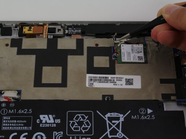

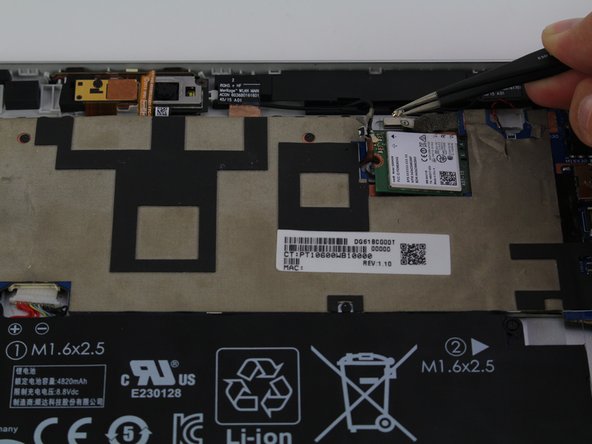

  8. HP Elite x2 G1 1012 WWAN Card Replacement: crwdns2935265:08crwdnd2935265:01crwdnd2935265:03crwdne2935265:0 HP Elite x2 G1 1012 WWAN Card Replacement: crwdns2935265:08crwdnd2935265:02crwdnd2935265:03crwdne2935265:0 HP Elite x2 G1 1012 WWAN Card Replacement: crwdns2935265:08crwdnd2935265:03crwdnd2935265:03crwdne2935265:0
    • Remove the two black wires that are connected to the board with a pair of tweezers.
