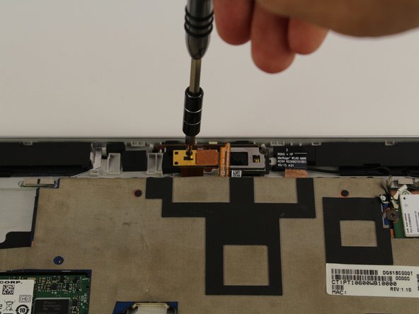

    • Use a Phillips #00 screwdriver to remove the screw.
  8. HP Elite x2 G1 1012 Front Facing Camera Replacement: crwdns2935265:08crwdnd2935265:01crwdnd2935265:01crwdne2935265:0

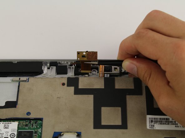

    • Use the spudger to gently lift up the camera.
  9. HP Elite x2 G1 1012 Front Facing Camera Replacement: crwdns2935265:09crwdnd2935265:01crwdnd2935265:02crwdne2935265:0 HP Elite x2 G1 1012 Front Facing Camera Replacement: crwdns2935265:09crwdnd2935265:02crwdnd2935265:02crwdne2935265:0
    • Use a pair of tweezers to disconnect the flex cable from the motherboard.
    • Remove the front-facing camera from the device.
