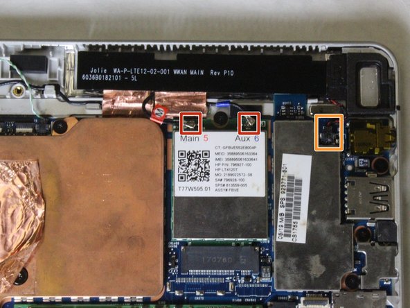

    • Remove the antennae connections from both the WiFi card and the wireless cellular M.2 card.
    • Gently pull the black and red wire free at the motherboard connector.

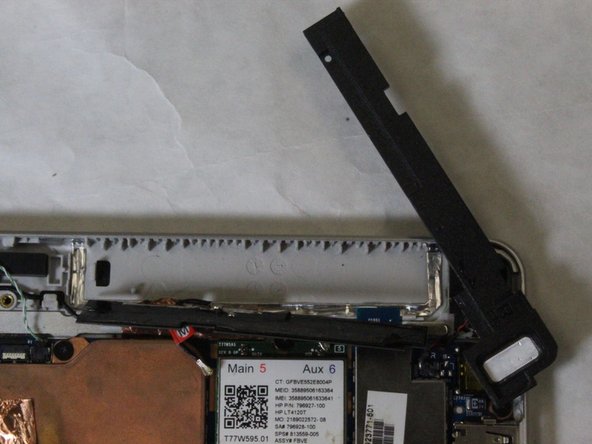

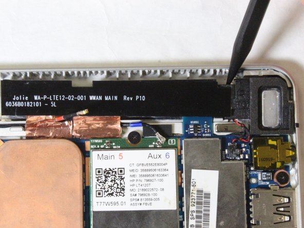

    • Use the spudger tool to remove the speakers from the housing.
  10. HP Elite x2 1012 G2 Speakers Replacement: crwdns2935265:010crwdnd2935265:01crwdnd2935265:02crwdne2935265:0 HP Elite x2 1012 G2 Speakers Replacement: crwdns2935265:010crwdnd2935265:02crwdnd2935265:02crwdne2935265:0

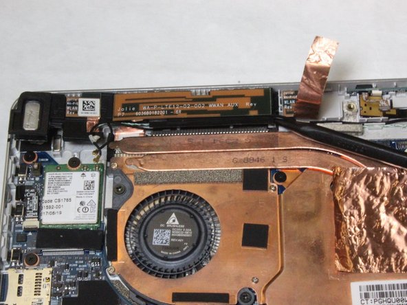

    • On the right speaker, the black antena piece must be removed before the speaker can be accessed.

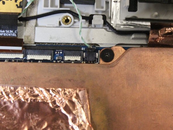

  11. HP Elite x2 1012 G2 Speakers Replacement: crwdns2935265:011crwdnd2935265:01crwdnd2935265:02crwdne2935265:0 HP Elite x2 1012 G2 Speakers Replacement: crwdns2935265:011crwdnd2935265:02crwdnd2935265:02crwdne2935265:0
    • Now remove the green and white wires from the cable management track and the speakers will be completely removed from the device.
