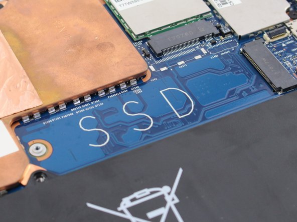

  7. HP Elite x2 1012 G2 SSD Replacement, SSD: crwdns2935265:07crwdnd2935265:01crwdnd2935265:01crwdne2935265:0
    • Orient the device so that the battery is closest to you.
    • The battery is the large, black rectangle at the bottom of the device.
  8. HP Elite x2 1012 G2 SSD Replacement: crwdns2935265:08crwdnd2935265:01crwdnd2935265:02crwdne2935265:0 HP Elite x2 1012 G2 SSD Replacement: crwdns2935265:08crwdnd2935265:02crwdnd2935265:02crwdne2935265:0
    • Remove the single Phillips M2.0x2.0 screw on the SSD using a Phillips screwdriver. Turn the screwdriver counterclockwise to remove the screw.
  9. HP Elite x2 1012 G2 SSD Replacement: crwdns2935265:09crwdnd2935265:01crwdnd2935265:02crwdne2935265:0 HP Elite x2 1012 G2 SSD Replacement: crwdns2935265:09crwdnd2935265:02crwdnd2935265:02crwdne2935265:0
    • Gently pull the SSD to the left and up to remove it from the device.
