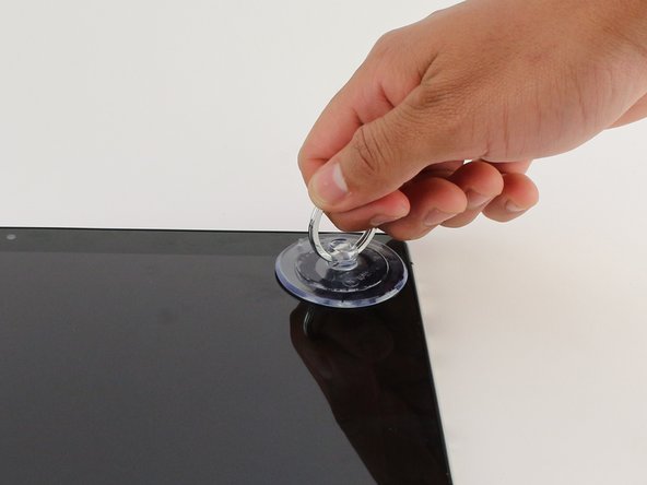

    • Turn the device over so the screen is facing you.
    • Place a suction cup firmly onto a corner of the screen.
    • Lift up gently until you see the screen separate from the casing.
    • Repeat this process for all four corners.
    • During reassembly, certain clips/edges may not snap into place properly even with a lot of force. To counteract this, lift the edge up, place the suction cup further inwards on the screen and pull it slightly upwards while pressing the edge of the screen downwards. The edge should snap correctly into the housing.

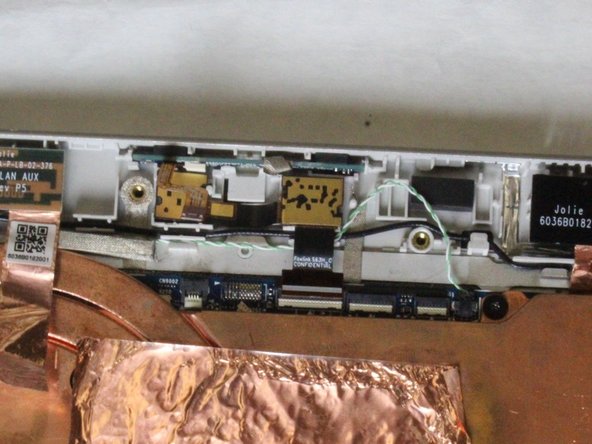

  7. HP Elite x2 1012 G2 Rear Facing Camera Replacement, Rear Facing Camera: crwdns2935265:07crwdnd2935265:01crwdnd2935265:02crwdne2935265:0 HP Elite x2 1012 G2 Rear Facing Camera Replacement, Rear Facing Camera: crwdns2935265:07crwdnd2935265:02crwdnd2935265:02crwdne2935265:0
    • Locate the cameras at the top center of the power and processing unit.
    • Use a Phillips #00 screwdriver to remove the single 3 mm screw.
    • Use a spudger tool to lift up the ribbon cable clamps.
    • Be careful not to crease or damage the ribbon cables or connectors.
  8. HP Elite x2 1012 G2 Rear Facing Camera Replacement: crwdns2935265:08crwdnd2935265:01crwdnd2935265:02crwdne2935265:0 HP Elite x2 1012 G2 Rear Facing Camera Replacement: crwdns2935265:08crwdnd2935265:02crwdnd2935265:02crwdne2935265:0
    • Remove the front-facing camera.
    • Remove the metal bracket securing the rear-facing camera.
    • Remove the rear-facing camera.
