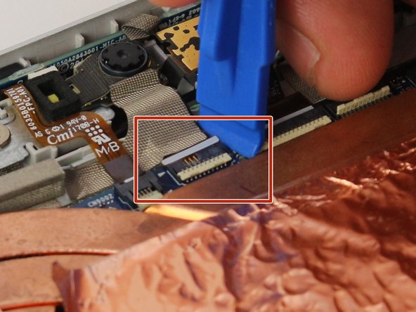

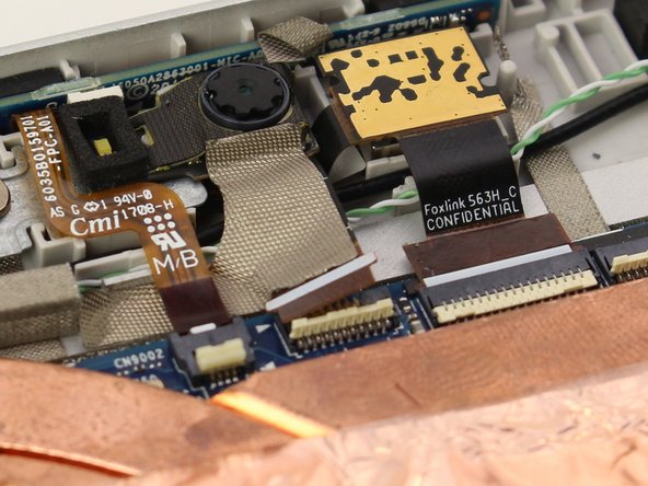

    • Remove the wire connector to the front webcam using a plastic opening tool. Hook the tool underneath the connector and pull up and back.
  9. HP Elite x2 1012 G2 Front Webcam Replacement: crwdns2935265:09crwdnd2935265:01crwdnd2935265:01crwdne2935265:0
    • Remove the connector immediately to the left of the front webcam's connector. Use a plastic opening tool to gently lift the connector up and out.
  10. HP Elite x2 1012 G2 Front Webcam Replacement: crwdns2935265:010crwdnd2935265:01crwdnd2935265:01crwdne2935265:0
    • Remove the connector immediately to the right of the front webcam's connector. Use a plastic opening tool to gently lift the connector up and out.

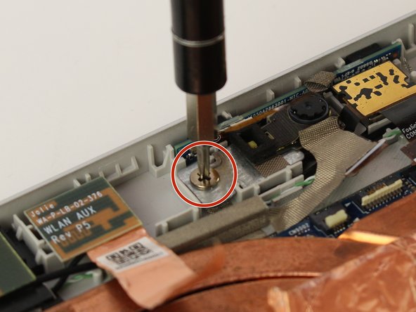

    • Use a Phillips screwdriver to remove the Phillips M2.0x2.0 screw to the left of the webcam. Turn the screwdriver counterclockwise to remove the screw.
