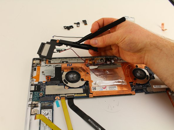

    • Remove the two speaker/antenna module mounting 2mm screws using a Phillips #00 Screwdriver.
  9. HP Elite X2 1013 G3 Fingerprint Scanner Replacement: crwdns2935265:09crwdnd2935265:01crwdnd2935265:02crwdne2935265:0 HP Elite X2 1013 G3 Fingerprint Scanner Replacement: crwdns2935265:09crwdnd2935265:02crwdnd2935265:02crwdne2935265:0
    • Use a spudger to gently pry the left black plastic speaker/antenna module off of the frame as pictured. Start by lifting up the right side of the module, then slowly work your way down the module towards the right.
    • The slight cracking sound you will hear is the sounds of plastic clasps.
    • We removed other peripherals from the frame so we could move the speaker/antenna module completely out of the way for photographing. You should not have to do this to replace just the fingerprint scanner.

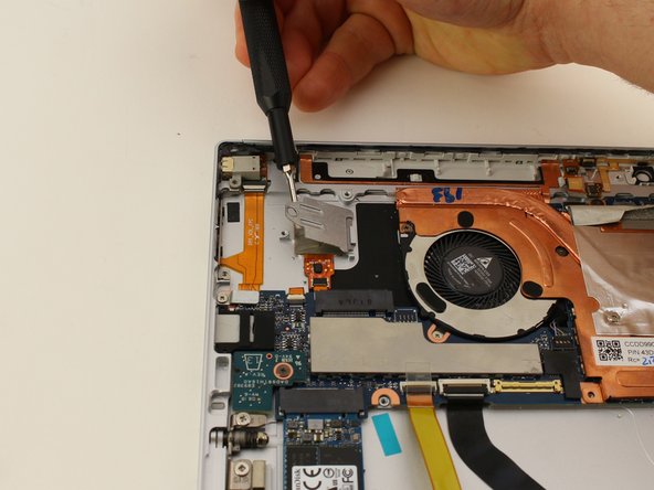

  10. HP Elite X2 1013 G3 Fingerprint Scanner Replacement: crwdns2935265:010crwdnd2935265:01crwdnd2935265:02crwdne2935265:0 HP Elite X2 1013 G3 Fingerprint Scanner Replacement: crwdns2935265:010crwdnd2935265:02crwdnd2935265:02crwdne2935265:0
    • Remove the 2mm bracket mounting screw from the frame using a Phillips #00 Screwdriver.
    • Lift up the bracket and set aside.

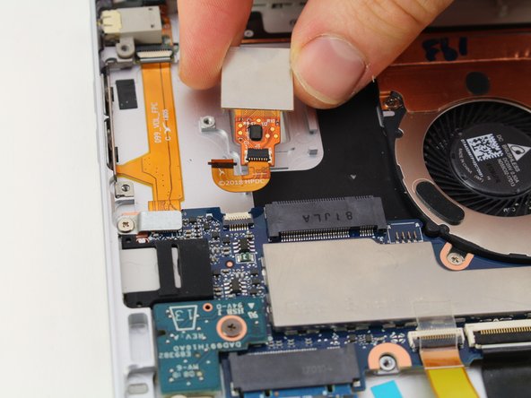

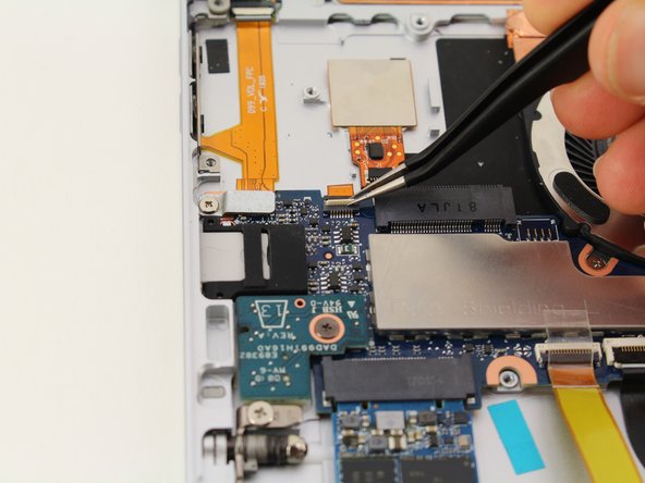

  11. HP Elite X2 1013 G3 Fingerprint Scanner Replacement: crwdns2935265:011crwdnd2935265:01crwdnd2935265:03crwdne2935265:0 HP Elite X2 1013 G3 Fingerprint Scanner Replacement: crwdns2935265:011crwdnd2935265:02crwdnd2935265:03crwdne2935265:0 HP Elite X2 1013 G3 Fingerprint Scanner Replacement: crwdns2935265:011crwdnd2935265:03crwdnd2935265:03crwdne2935265:0
    • Open the ribbon cable clamp and pull the cable out.
    • You may require tweezers to slide the ribbon cable out of the clamp.
    • Lift out the fingerprint scanner.
