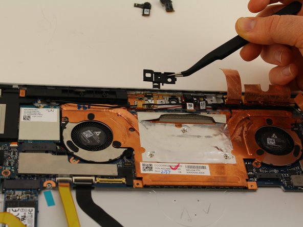

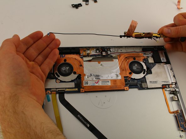

  12. HP Elite X2 1013 G3 Fan Replacement: crwdns2935265:012crwdnd2935265:01crwdnd2935265:03crwdne2935265:0 HP Elite X2 1013 G3 Fan Replacement: crwdns2935265:012crwdnd2935265:02crwdnd2935265:03crwdne2935265:0 HP Elite X2 1013 G3 Fan Replacement: crwdns2935265:012crwdnd2935265:03crwdnd2935265:03crwdne2935265:0
    • Use tweezers or your finger to unclasp and remove the upper right module with the copper tape and wire. Start by popping up the left side of the module.
    • Continue to pry up the module toward the right.
    • At this point, all connectors have been undone in previous steps, but if you notice any wires securing the module, do not keep pulling! Gently undo any connectors before proceeding.
    • Gently lift the whole module out, including the trailing wire.

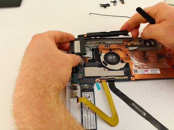

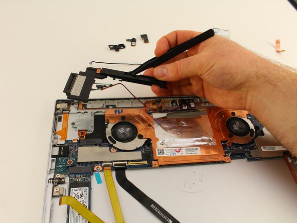

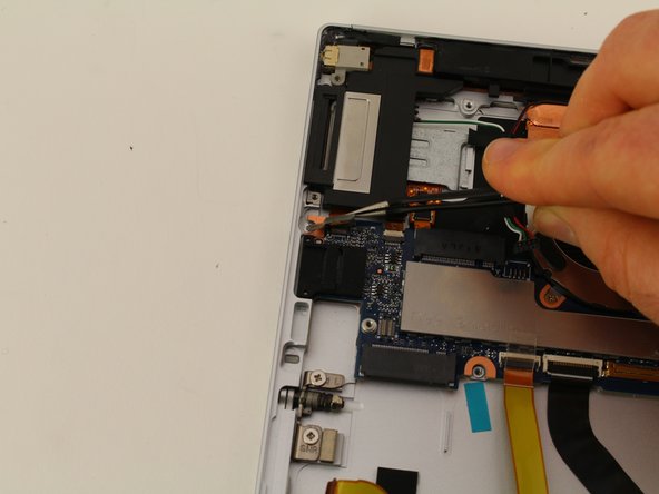

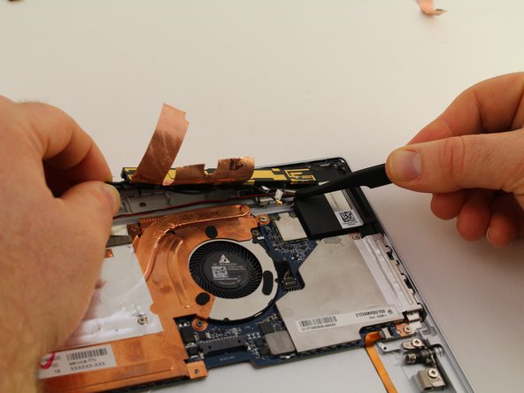

  13. HP Elite X2 1013 G3 Fan Replacement: crwdns2935265:013crwdnd2935265:01crwdnd2935265:03crwdne2935265:0 HP Elite X2 1013 G3 Fan Replacement: crwdns2935265:013crwdnd2935265:02crwdnd2935265:03crwdne2935265:0 HP Elite X2 1013 G3 Fan Replacement: crwdns2935265:013crwdnd2935265:03crwdnd2935265:03crwdne2935265:0
    • Using a spudger, pry the left black plastic speaker/antenna module off of the frame as pictured. Start by lifting up the right side of the module, then slowly work your way down the module towards the right.
    • The slight cracking sound you will hear is the sounds of plastic clasps.

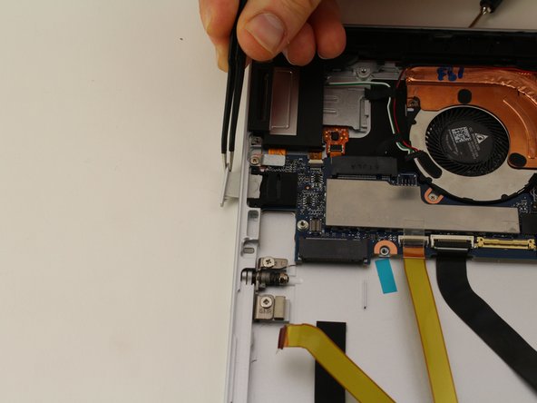

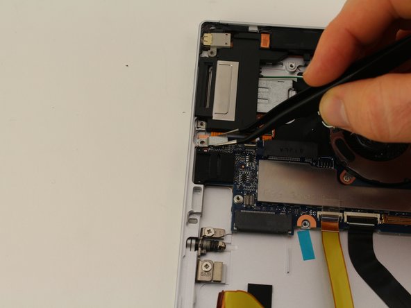

  14. HP Elite X2 1013 G3 Fan Replacement: crwdns2935265:014crwdnd2935265:01crwdnd2935265:01crwdne2935265:0
    • Undo the two indicated connectors near the fan using your fingers or tweezers.

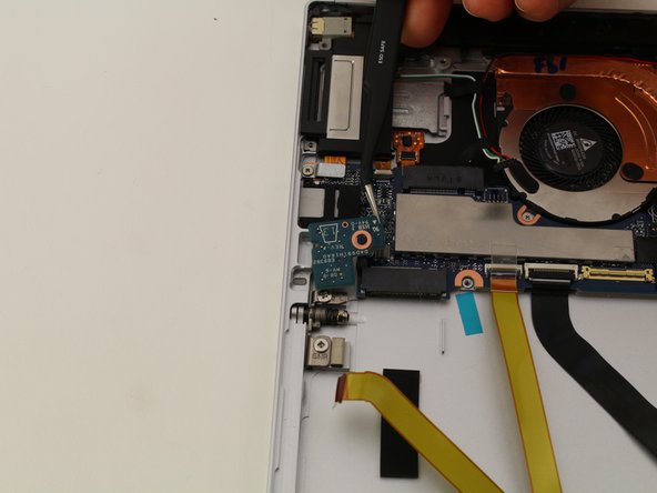

  16. HP Elite X2 1013 G3 Fan Replacement: crwdns2935265:016crwdnd2935265:01crwdnd2935265:02crwdne2935265:0 HP Elite X2 1013 G3 Fan Replacement: crwdns2935265:016crwdnd2935265:02crwdnd2935265:02crwdne2935265:0
    • Unscrew the single 2mm screw from the peripheral board with the same screwdriver, and remove the peripheral board from the motherboard.
  17. HP Elite X2 1013 G3 Fan Replacement: crwdns2935265:017crwdnd2935265:01crwdnd2935265:02crwdne2935265:0 HP Elite X2 1013 G3 Fan Replacement: crwdns2935265:017crwdnd2935265:02crwdnd2935265:02crwdne2935265:0
    • Remove the SD Card holder from the motherboard.

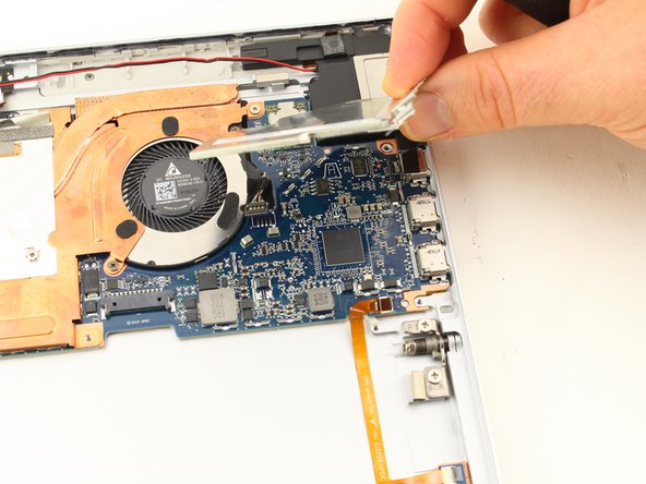

    • Lift up the flap on the right of the indicated plate, and lift the whole covering off.
  21. HP Elite X2 1013 G3 Fan Replacement: crwdns2935265:021crwdnd2935265:01crwdnd2935265:01crwdne2935265:0
    • Use tweezers or your fingers to undo the black ribbon connector.
  22. HP Elite X2 1013 G3 Fan Replacement: crwdns2935265:022crwdnd2935265:01crwdnd2935265:01crwdne2935265:0
    • Remove the whole assembly, granting access to the fans.
