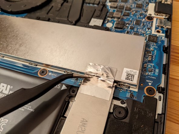

  2. HP ENVY x360 Laptop - 15-ee0003ca memory/RAM Replacement, Remove the shield: crwdns2935265:02crwdnd2935265:01crwdnd2935265:03crwdne2935265:0 HP ENVY x360 Laptop - 15-ee0003ca memory/RAM Replacement, Remove the shield: crwdns2935265:02crwdnd2935265:02crwdnd2935265:03crwdne2935265:0 HP ENVY x360 Laptop - 15-ee0003ca memory/RAM Replacement, Remove the shield: crwdns2935265:02crwdnd2935265:03crwdnd2935265:03crwdne2935265:0
    • The RAM/memory is located under the metal shield.
    • Remove the metal tape, being gentle to not tear it, leave it attached to the other shield.
    • Pull up the shield using a plastic tool or other sharp object. There are small metal clips all around the shield, these don't need to be touched, gently force will pop the cover off.
